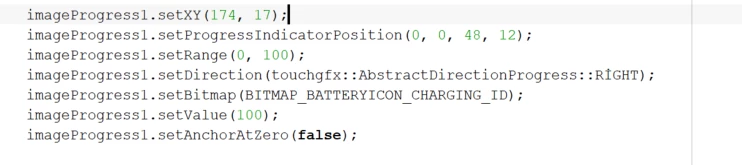

I have an imageProgress in my design and I choose Appearence direction to right in designer.
After clicking generate code button, firmware cannot be compiled. When I look at the ScreenViewBase.cpp I see below code for error.
 imageProgress1.setXY(174, 17);
 imageProgress1.setProgressIndicatorPosition(0, 0, 48, 12);
 imageProgress1.setRange(0, 100);
 imageProgress1.setDirection(touchgfx::AbstractDirectionProgress::RİGHT);
 imageProgress1.setBitmap(BITMAP_BATTERYICON_CHARGING_ID);
 imageProgress1.setValue(100);
 imageProgress1.setAnchorAtZero(false);
"I" character of right text is with a dot, so it cannot be compiled. compiler gives error about unknown character.
In Turkish there are upper characters of "i" with dot or without dot. Although this is a compiled code, I though maybe its a problem about my pc language. I changed my pc and keyboard language to English but it still has same problem.

Sorry, if I am miss understanding but it looks like that your fix is;
Change below line;
as;
imageProgress1.setDirection(touchgfx::AbstractDirectionProgress::RIGHT);
RİGHT -> RIGHT

Yes, I can change this line but it is touchgfx generated code.
So I dont want to touch this code. but if there is not a solution for this problem, I will edit generated code.
I am waiting a comment from ST.
