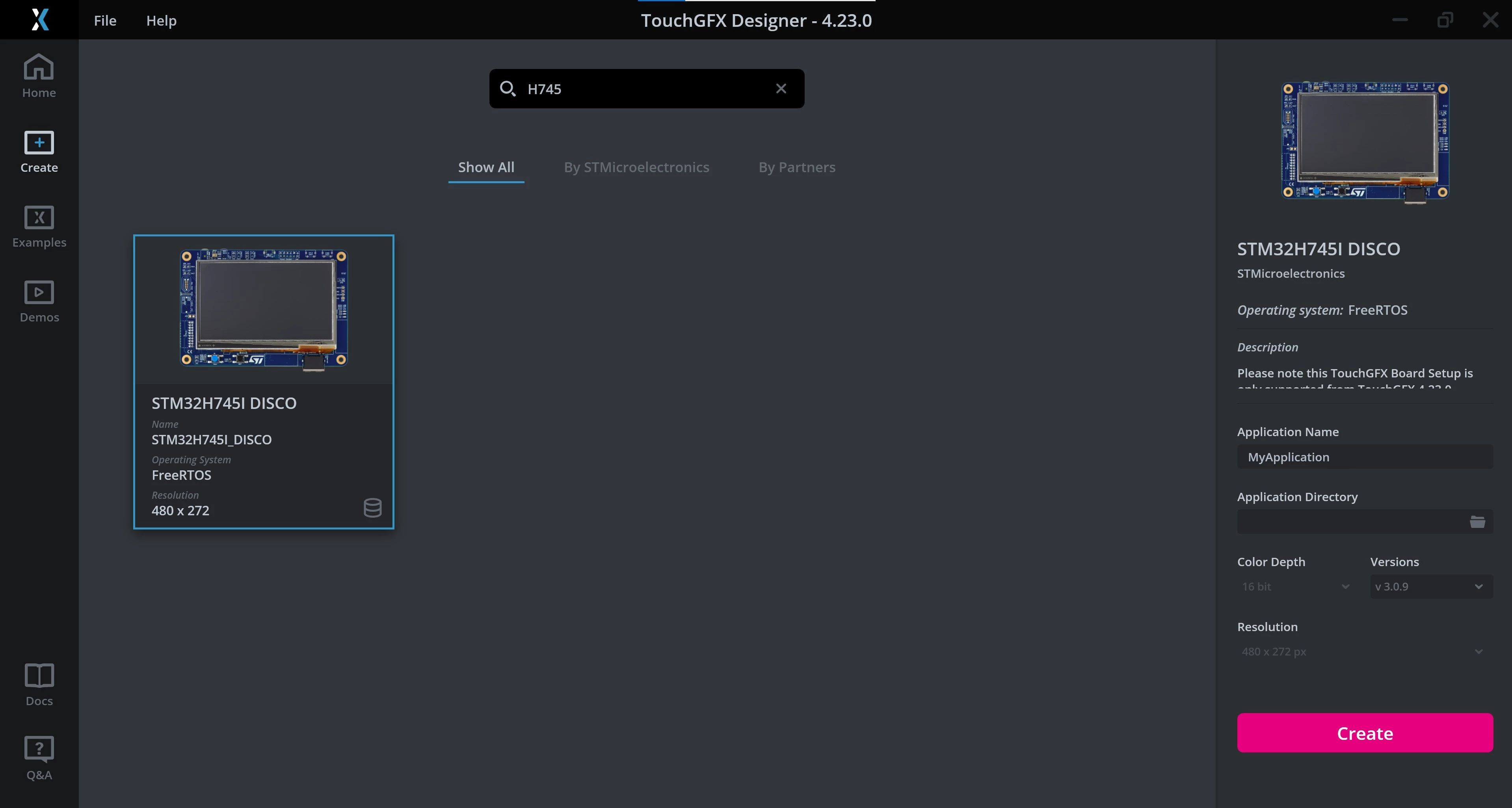

    Actually, I found that there was no problem with the Text Area, but it is with my SDRAM Initialization in STM32H745I Discovery Board. Without the SDRAM Initialization it is working fine. (i.e. using the internal memories rather than the initializing of the external peripherals). Iam using the MT48LC4M32B2 part number SDRAM in this STM32 Board.
    Iam attaching the SDRAM related files that I have used in the SDRAM Initialization in my project. kindly check the files and let me know the reasons of screen flickering.

    Hello again,
    There is already a board setup ready for STM32H745I Discovery in the TouchGFX Designer that you can easily use to develop your application, and SDRAM and other required parts are already configured.
    STM32H745I DiscoverySTM32H745I Discovery
    Is there any specific reason that you are not using this setup?
    If you still want to use your own configuration, you can consider this setup as inspiration.
    I hope this helps you
