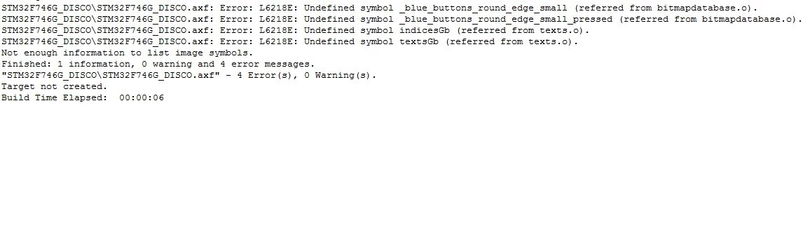

Hi.
I create project in touchgfx and run ok on 32F746G-DISCO board.
But in keil compile error. image of errors in attach
please help me.
thanks

Try the following:
  • Open the cubemx project.
  • Go to project manager: Select MDK-ARM
  • Save
  • Go to touchgfx designer and re-generate code
/MArtin

Thanks for your comment, it worked in my case.
I have new error now, it's 'Insufficient RAM for Flash Algorithms !'
How to fix it?
very thanks

Its ok.
I increase algorithms ram of my project to 0x0800 and fix.
