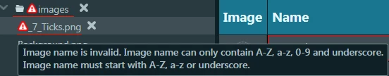

Image file names starting with an underscore do not work

Even though the error message in the Designer indicates that an image file name can begin with an underscore, the TouchGFX Designer is complaining about it:
This might be something you may want to look into.

You're absolutely right; Thanks for the heads up. I just bonked a guy from the designer team on the head and made him create a ticket for it - The validation is not correct, as you stated, because images starting with underscore should be completely fine.
/Martin
