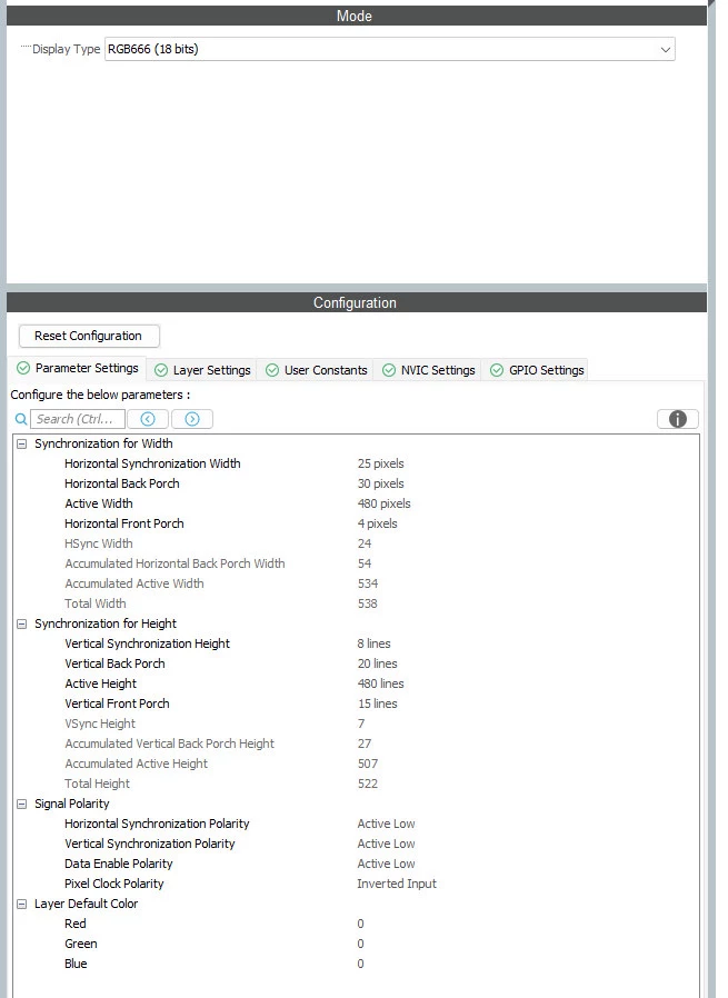

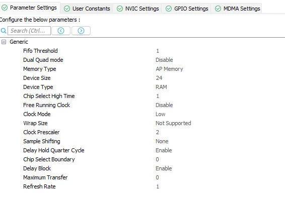

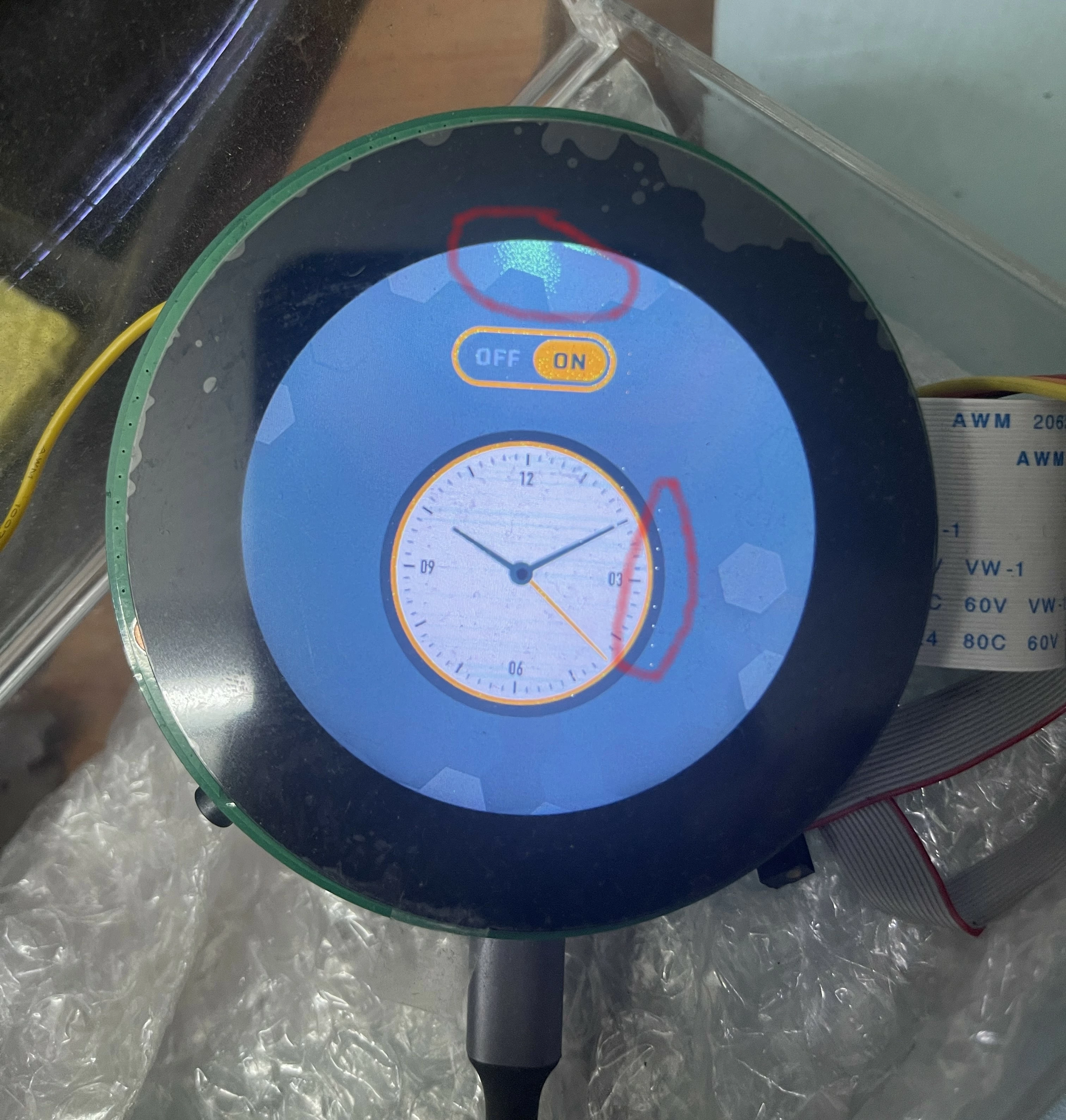

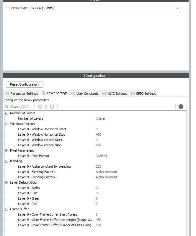

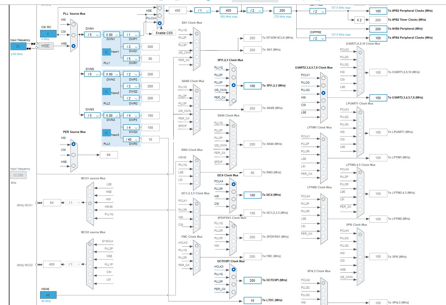

As title, I have a custom board using STM32H723ZGT6, RGB666 LCD (480 * 480) with LTDC interface, the framebuffer used external Octo SPI PSRAM APS12808L-3OBM-BA of APMemory. I can display image using TouchGFX, but the image always noisy with some green pixels ramdom, I try with others image, but it still appear (see image)Untitled.jpg
Below is my configuration for system clock, OSPI, LTDC
APS12808APS12808LTDCLTDCRGB LCDRGB LCDSystem clockSystem clock

Hello @duchuylee ,
Your issue looks like this that have been talked in the forum: Solved: Problem when I use external SRAM in touchgfx. Wron... - STMicroelectronics Community.
For that could you please take a look at this thread and let me know if the issue is solved or not?
I hope this help you.
Kaouthar

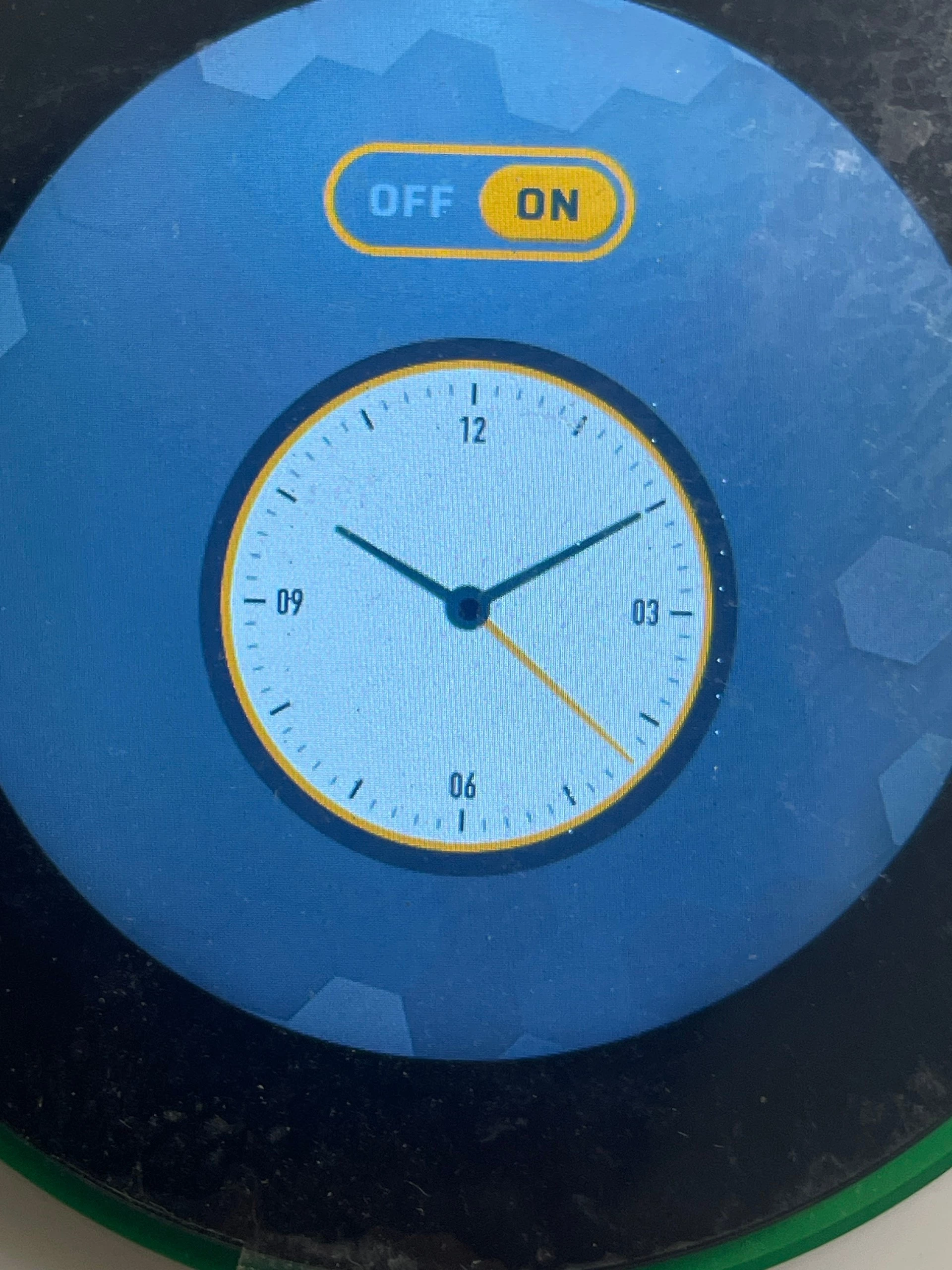

duchuyleeAuthor
Jun 6, 2024 6:15 AM UTC
Hello @KDJEM.1
The good news
I tried as you recommended in the link above: adding a 120-ohm resistor to the CLK and RWDS pins of the PSRAM. The green pixels are no longer appearing (although there are still some white pixels in a line, but this problem is really solved) (see image below). Once again, I am very grateful for your help! :smiling_face_with_smiling_eyes:
