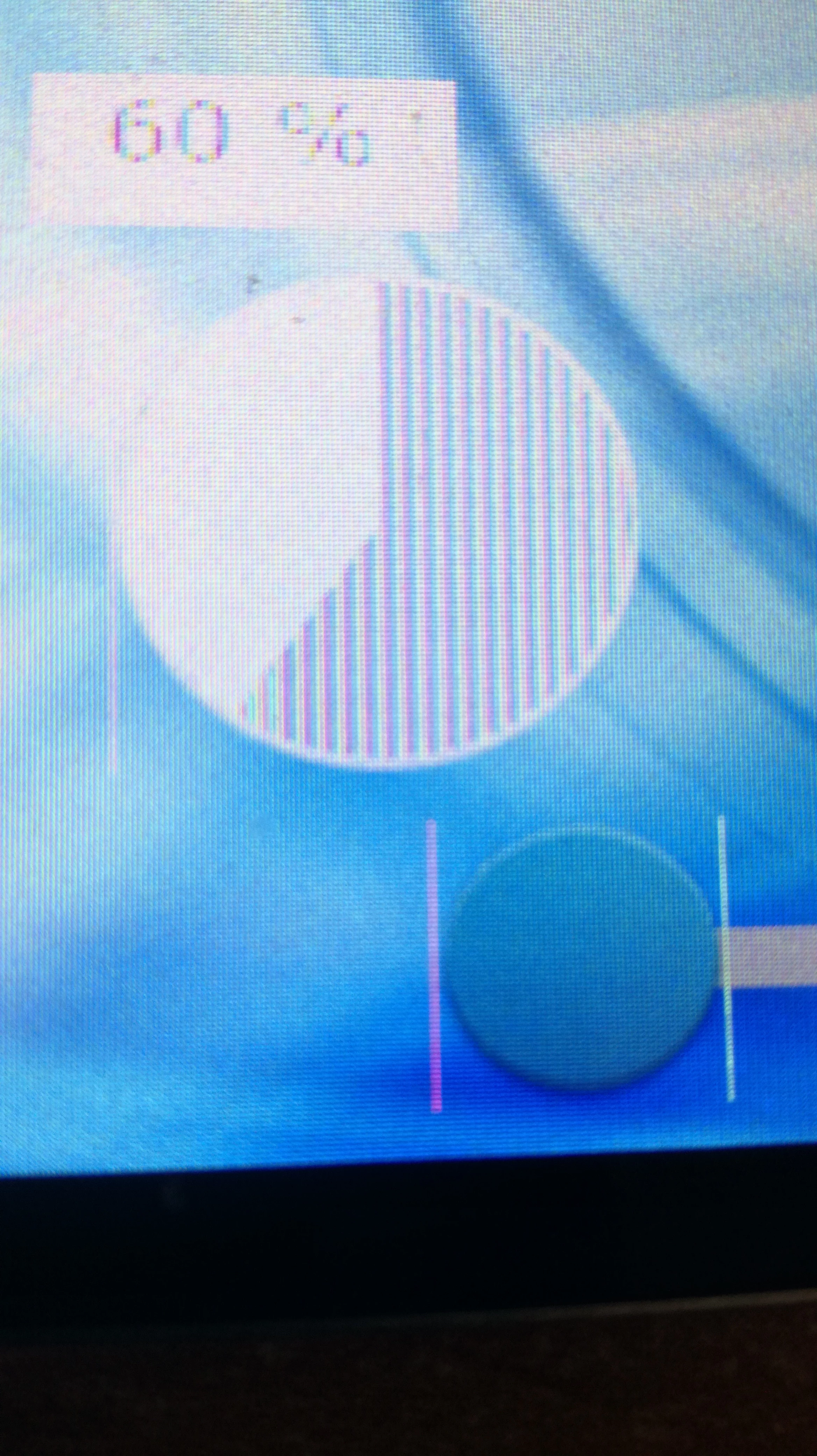

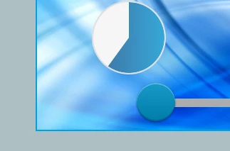

Image defect
Look at the project
and look at the display
You can see artefacts.
Why?
19 replies
Feb 16, 2020 11:25 AM UTC
Hm.... I can delete vertical lines near pictures if I use 32-bit SDRAM as 16-bit (I reconfigured FMC). But I want to use all 32 bit. Is it bug of your library?
And stripes on circle still present, even in 16 bit mode....
Feb 16, 2020 1:23 PM UTC
Stripes on circle disappeared, if I use RGB565...
But I want RGB888.
How?

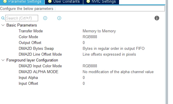

I disabled ChromeART (DMA2D) in CubeMX options - artifacts disappeared.
Tell me, what's may be wrong with ChromeART (DMA2D) ???? How to fix?
Feb 18, 2020 5:01 AM UTC
Here is my DMA2D options
Feb 18, 2020 7:49 PM UTC
Anybody help me!!!
