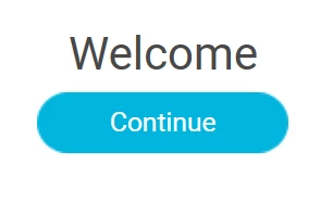

For the application I am building in TouchGFX, the image and text quality is very good and crisp in developed screen. However, the quality/resolution is not retained in simulation. Below are the before and after pictures.
In this picture, both the "Welcome" text and the button label "Continue" are very crisp. This is from development screen in TouchGFX.

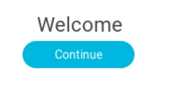

0693W00000AQ5KSQA1.pngPicture below is from simulation window. As can be seen, both the texts are not as crisp as above picture. This loss of quality is observed with images too (compare the blue button image itself).
Please advice what settings I might be missing.

Hello @BGuth.1​ ,
Have you fixed your issue ?
By default, TouchGFX should work perfectly on simulator.
Maybe as indicated by MM.1, your computer does not allow the right resolution for the simulator application of TouchGFX. I've never encountered this issue and I used TouchGFX on many computers so I cannot tell you exactly what is wrong. It can be your display scaling.
Try to search on Google about "low resolution issue on some application on Windows".
/Alexandre

Hi @JJ.Lin​ ,
Thank you for your reply. My issue is happening with simulation and not with a hw. So, no IO pins. Also, the text "Welcome" and the button label "Continue" in my pictures are standard TuchGFX widgets.
May I know what pix format of touchgfx are you using?
What MX configuration are you using?

Maybe you dont understand how PC display correct in application screen resolution. But simulator or hw not have this correction or use other based on for example settings in Text resources font setup. For example bits per pixel in font window setup how deep will be text antialiased usw. Too learn what is DPI...

It seems it is my computer. I finally go the target board and graphics looks fine on LCD. I was concerned if it was going to look the same way as it looked on my computer.
