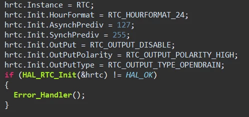

Im new to CubeIDE. When Setting up RCC (Low speed clock) to crystal resonator and adding clock and calendar in RTC, it says the HAL_RTC_Init is not defined.. how can I fix this?

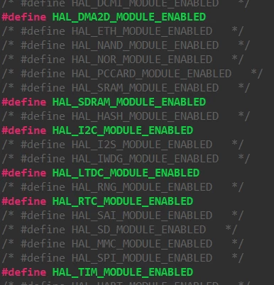

It means that the HAL RTC files haven't been included. Open up the *_hal_conf.h file and RTC module is enabled with the line:
#define HAL_RTC_MODULE_ENABLED

@TDK​ if u mean to enable it looks like it is already enabled
March 2, 2022
No, in *_hal_conf.h. The line should already be in there, ensure it's not commented.

Yes the above picture in inside hal_conf.h as you can see the second last define shows it has been enabled by default.

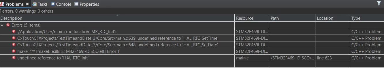

I'm not sure, looks like it should be working. Can you post the exact error message(s) you're getting?

March 2, 2022
The Console tab has the exact error message. The Problems tab is the IDE’s “helpful�? way of reordering things, which is less than helpful.
The full output from the console tab would show the actual issue. Solving it is another thing. Looks like the RTC file isnt being compiled.
