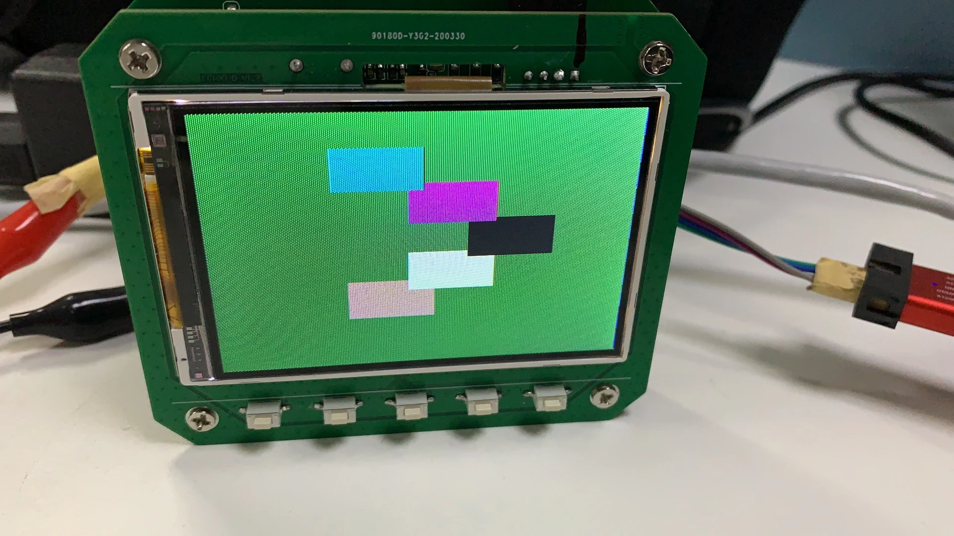

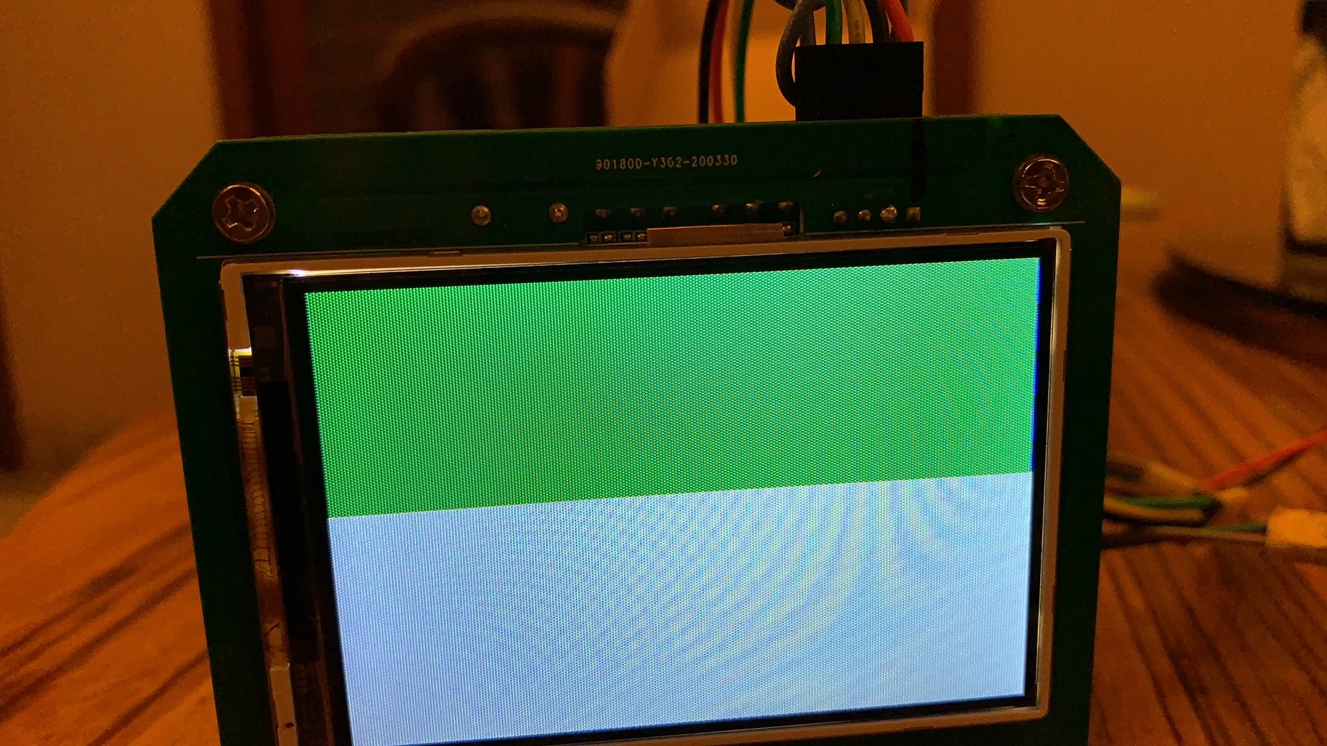

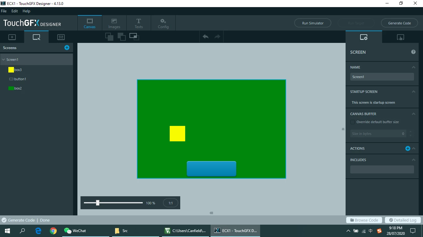

Hi
I used partial frame buffer + FSMC.A strange thing happened to me.Any monochrome can fill an entire screen.But if you use more than one color, GFX will no longer fill when it encounters another color.
Did I do something wrong?

Thank you very much for your answer.
Yes there are.
The problem of not being able to fill the entire screen is now resolved.

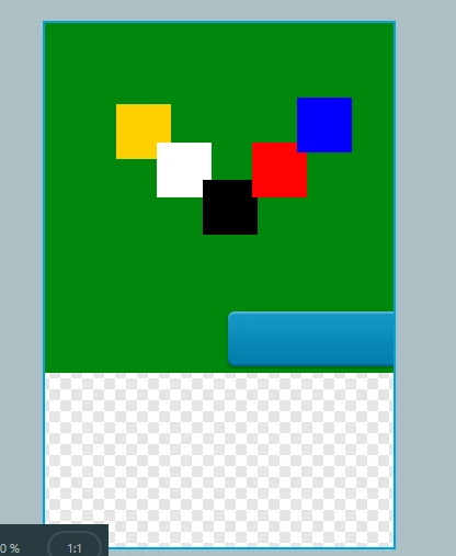

Now there's a new problem. The image seems to be stretched.
And only half of the images in the designer are displayed.
​I noticed the comment "//Change to SPI datasize to 8 bit from 16 bit".
Can only use 8 bit data transfer? I'm using a 16-bit data transfer here.

If I just initialize the screen, the screen will only show backlight, no other colors.
The following files are the main changes I made using GFX. Would you please have a look at them?
Maybe I have a problem with the initialization of the screen?
