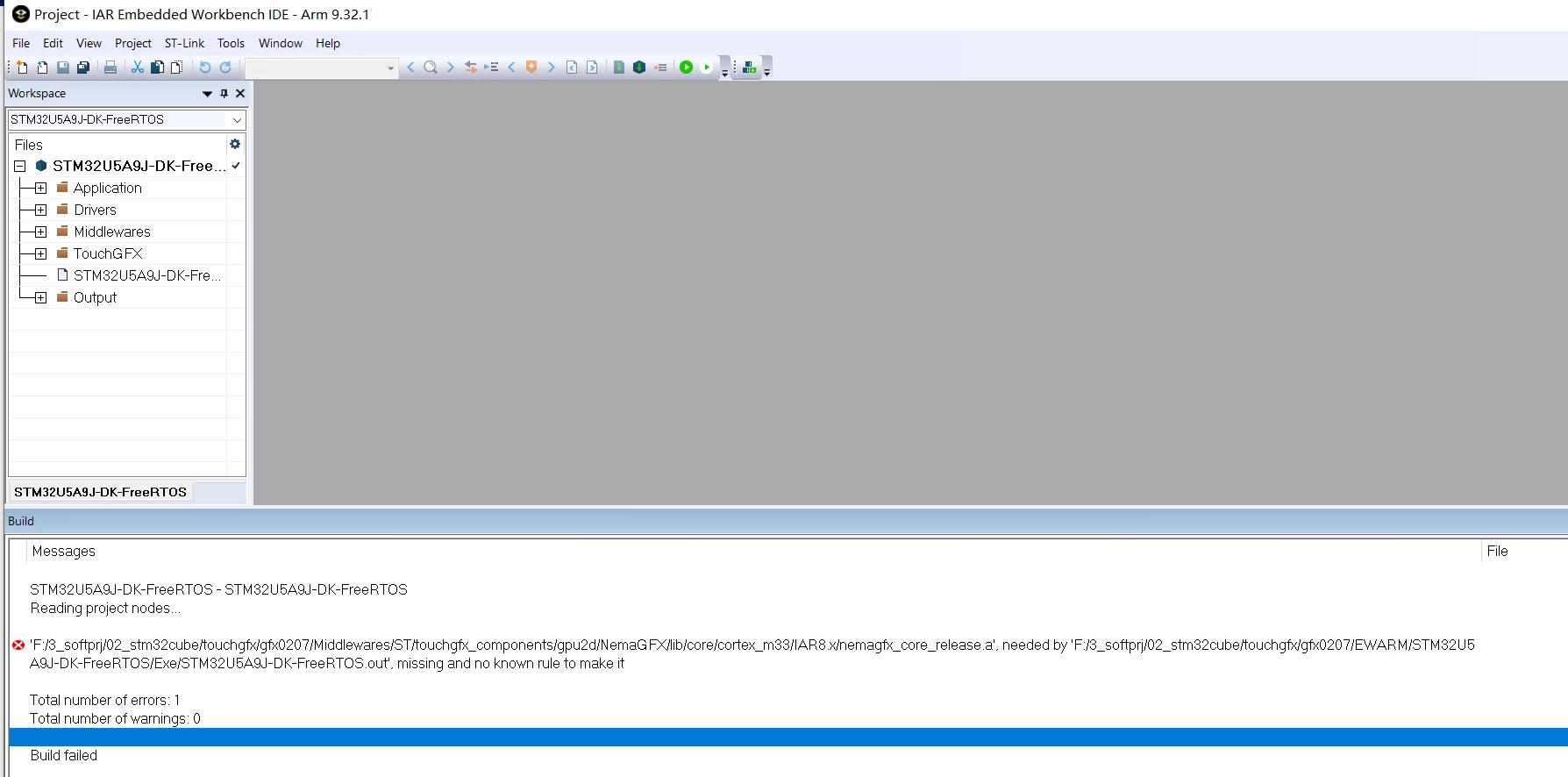

1.  Hardware is STM32U5A9J-DK.
2. Using TouchGFX Designer-Demo6 to 'Generate Code', 'Run Simulator', 'Program and Run Target', STM32U5A9J-DK works well.
3. When I want to compile the generated code in step 2 by IAR IDE, error occurs:
'F:/3_softprj/02_stm32cube/touchgfx/gfx0207/Middlewares/ST/touchgfx_components/gpu2d/NemaGFX/lib/core/cortex_m33/IAR8.x/nemagfx_core_release.a', needed by 'F:/3_softprj/02_stm32cube/touchgfx/gfx0207/EWARM/STM32U5A9J-DK-FreeRTOS/Exe/STM32U5A9J-DK-FreeRTOS.out', missing and no known rule to make it

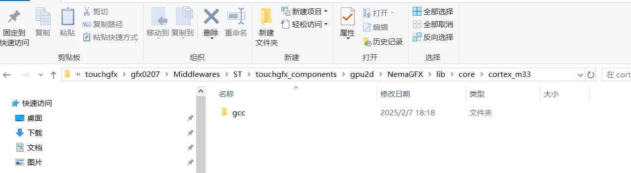

There is no IAR8.x in directry 'F:/3_softprj/02_stm32cube/touchgfx/gfx0207/Middlewares/ST/touchgfx_components/gpu2d/NemaGFX/lib/core/cortex_m33', besides gcc.
IAR version is 9.32.
why does the compiling error occur?

    Hello @rhine1012 ,
    Please refer to the documentation here : 1. Create Project | TouchGFX Documentation,
    BR,
    Louis BOUDOST Software Engineer | TouchGFX
