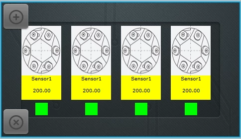

I have used STM32F746G-DISCO Kit.
I have prepare Custom Container.
Custom Container contain Following Widget:
  1. BOX (Back Ground)
  2. Image
  3. Text Widget (For display Value)
  4. Image or Box (For display status, GREEN,RED,YELLOW).
Now, I would like to create the design like when i touch on custom container, It will display the Custom Container Information (It is like Tool Tip).

In My application,
I placed my Custom Container in "ListLayout" Horizontally.
So, Suppose Currently 4 sensor is displayed.
For each Sensor i need to display its information.
In, Modal Window i need to used image for display.
In, My Case sensor information is updated every time. Information is not static.
So when ever i touch the custom container latest information has to display.
Can you please guide me, how to deal with this kind of situation.
