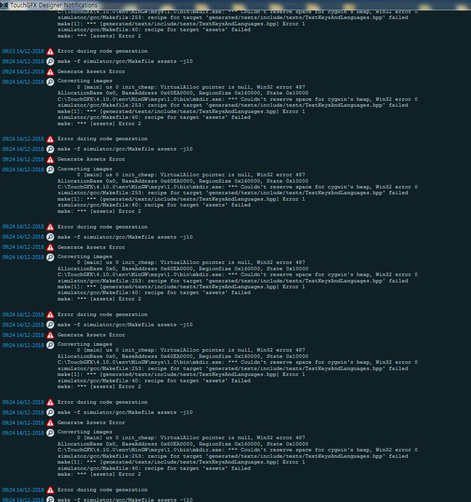

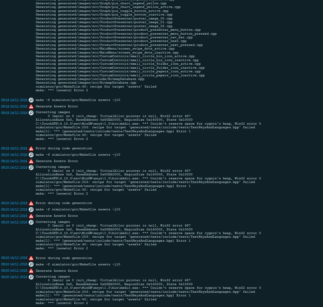

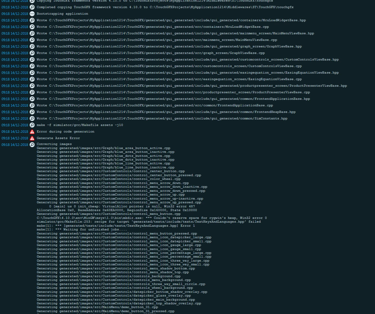

Hi.
I will contact you with an unknown error.
When this error message is displayed, the run simulator, run tag, generater code, etc. can not be executed.

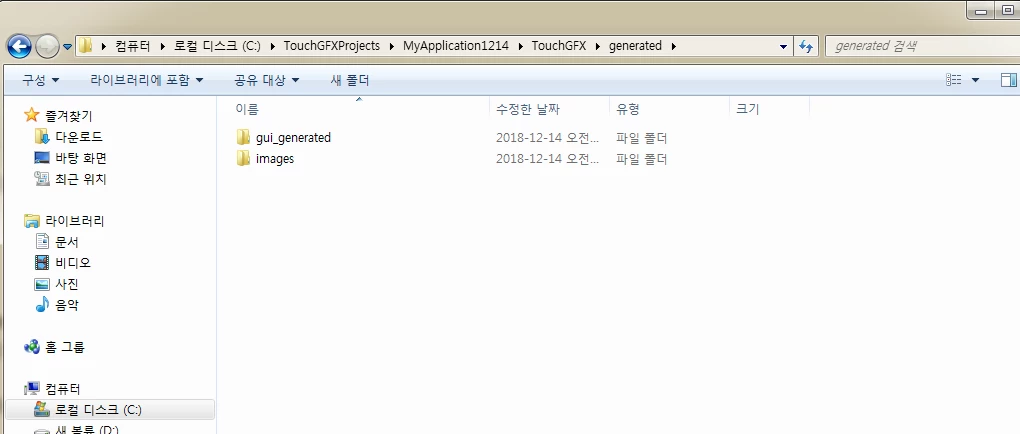

I noticed that some of the code in the 'generated' folder should be missing.
Please tell me how to fix it.
Below is an error message.

Which version of windows are you using? Also, this issue can be related to low disk space preventing virtual allocation to function correctly. Could you check that?

​Thank for your reply.
I use window7 professional.
Hard disk capacity remains 21gb.

I solved this problem partly by changing the base address of msys-1.0.dll.
The code in ac6 is still not created properly.
I am trying to fix the error code.
