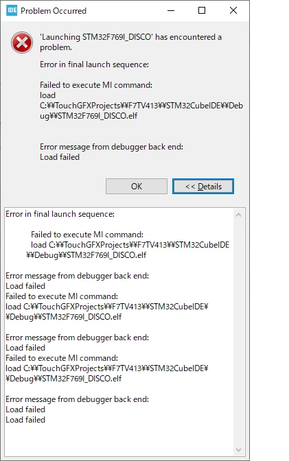

I want to debug STM32F769I-DISCO
Hello.
environment
STM32CubeIDE Ver1.3.0
STM32CubeMX Ver5.5.0
TouchGFX Ver4.13.0
Double-click the following .project created by TouchGFX to start the IDE.
Build is OK.
After that, when Run-Debug, the following error message appears and it does not work.
What should I do?
Thank you.

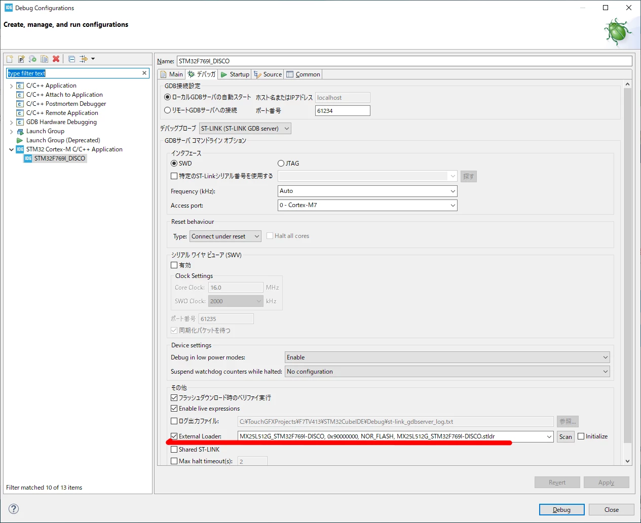

You need to add an external flashloader to your project. You can do that from the project settings.

Dear Martin
Thank you for helping.
Configured as attached in Debug Configurations.
The result is the same.
What to check next?
Thank you.

Dear ScottSD
Editing the linker script solved
