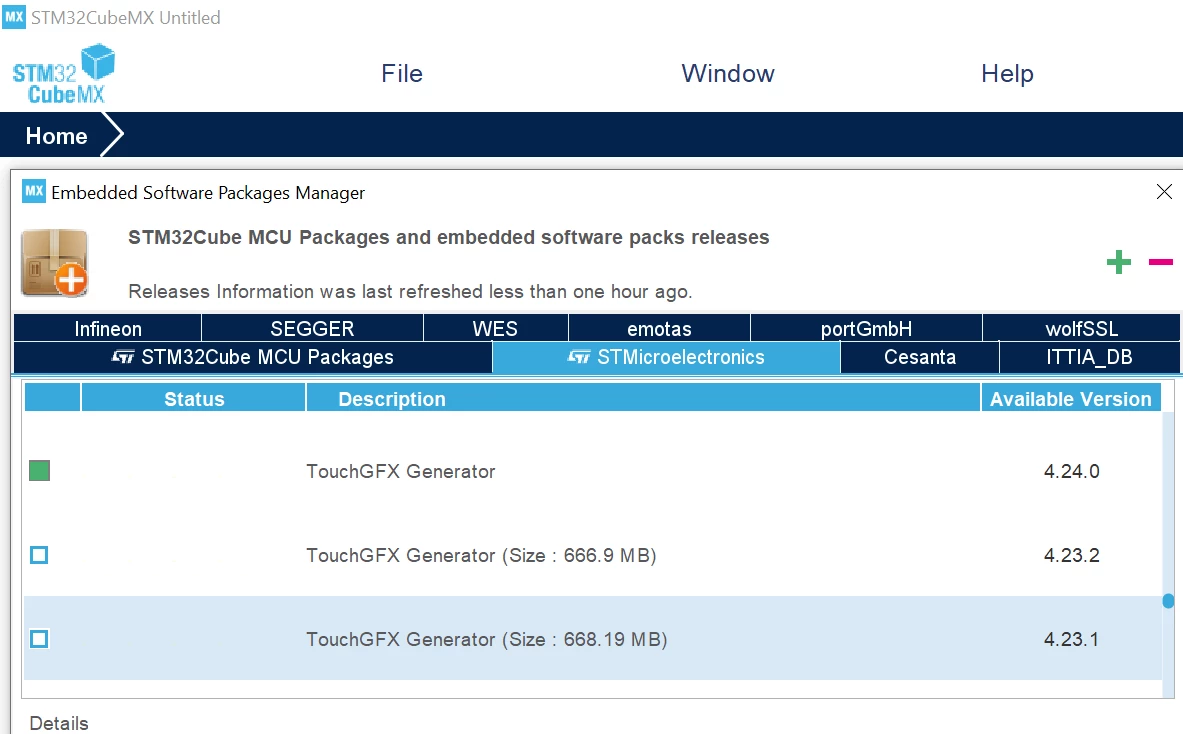

TouchGFX is made of 3 parts:
  • TouchGFX Engine
  • TouchGFX Generator
  • TouchGFX Designer
You have to make sure you have the latest version of TouchGFX Generator.
To do so, open STM32CubeMX, then click "Help" => "Manage embedded software packages":
Then, go to "STMicroelectronics", scroll at the bottom to find "X-CUBE-TOUCHGFX" and expand the list. This is what I see with the latest TouchGFX Generator:
If you do not see "TouchGFX Generator 4.24" in green (on the left):
Then you have to install it.
Click on "Refresh" and select the TouchGFX Generator you want to install.
Once you have selected one, the "Install" button will become clickable:
Install it and you should be good.
Alternatively, you can select "From local" and give a file (.pack or .msi if I remember correctly) with the new generator.
You can find the full download of 4.24 here : st.com/en/embedded-software/x-cube-touchgfx.html#get-software

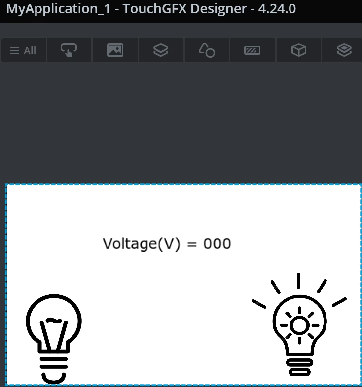

It seems as though I already have that piece put together.
 I did not need to change anything from the current configuration.
I made this quick example to test if anything changed now that I had the STM32MX software.

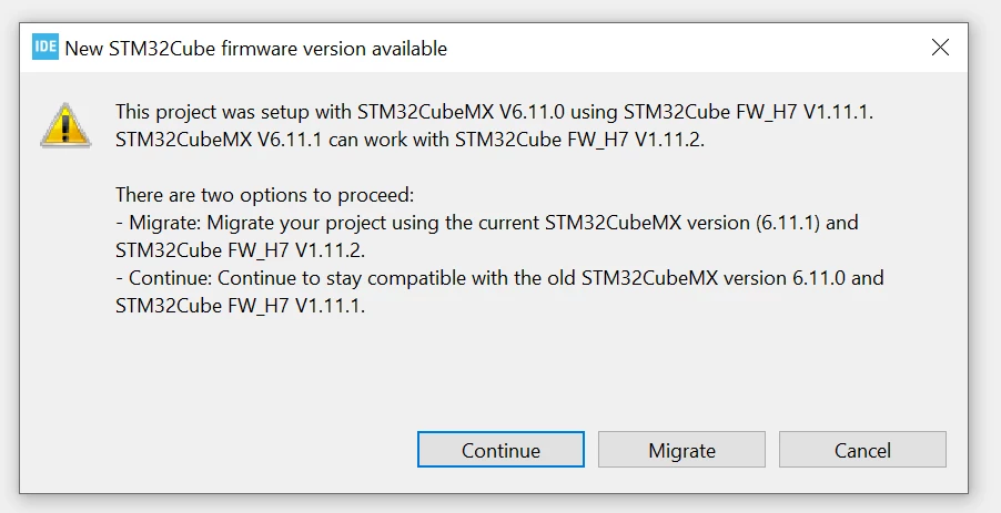

Although, when I bring it over to the STM32IDE to do scripting I get this message.
This is the same message I got and asked about in a previous post. Without rehashing that post to much, I am not able to generate GPIO and pinout code correctly if I hit continue. If I hit migrate I am able to script fine but if I need to change the gui on TouchGFX and generate code on that software it now slowly degrades my display until there is nothing left but a white screen. I wanted to see if there if a way to make TouchGFX generate code for STM32CubeMX(Which is currently downloaded at 6.11.1) and to generate code compatible with STM32Cube FW_H7 V1.11.1
Thank you for any time you can spare to help.
GaetanGodart
Jul 1, 2024 10:10 AM UTC
You should migrate indeed.

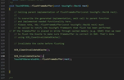

4) I also tried to edit my code in this file according to a different post I made about the same issue.
