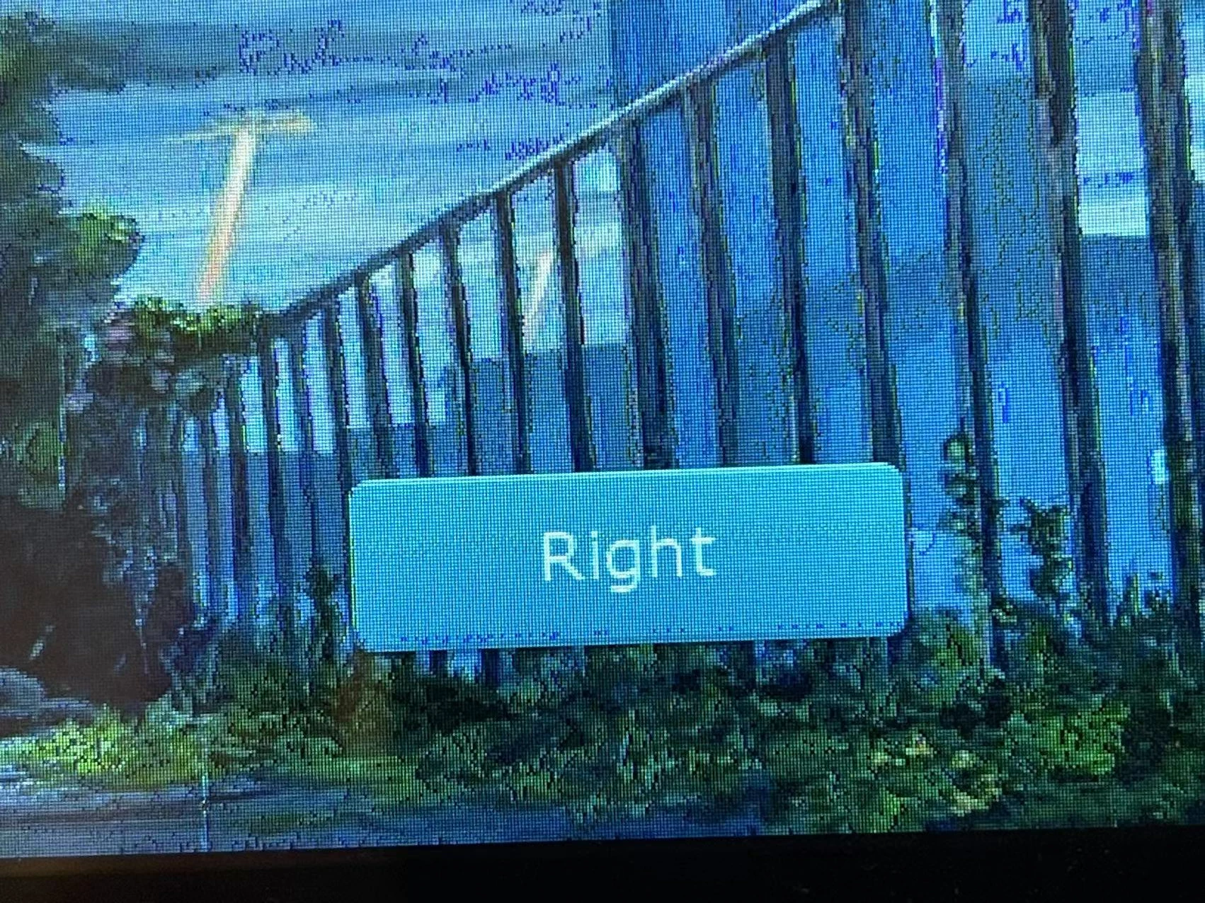

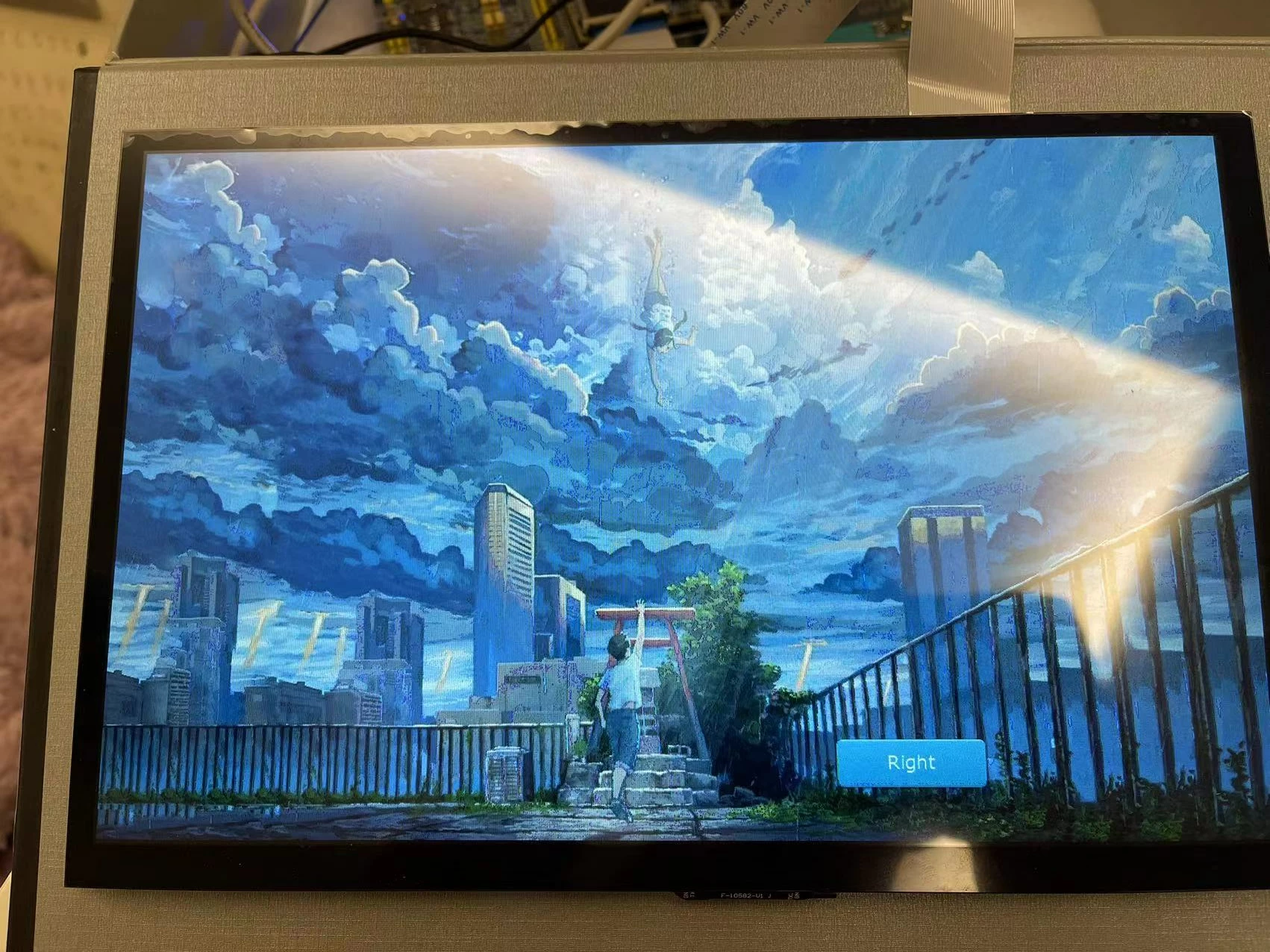

I used the STM32 F767 custom development board, using the TouchGFX to drive the RGB screen, but when the picture is displayed, noise point

Seems you use 565 RGB and all images is convrted to this format with dithering, or you have an hw trouble...

Yes, the RGB565 used, but the button is generated by TouchGFX, and there is noise display separately.

Currently, it is the transparency cause, which reduces transparency can be reduced, but it is impossible to remove it. I don't know how to deal with it.
