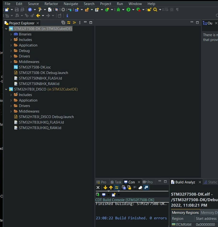

I use TouchGFX 4.19.1 Designer and STM32CubeIDE 1.9.0. The project imported in STM32CubeIDE doesn't contain the ioc file for STM32F7B3I Disco. However, for STM32F7508-DK the file is present. It's a bug?

Hello florinn2520,
Indeed there's a bug here, you're right. I'll get back to you when we'll have a fix for that.

Hello florinn2520,
We patched this issue. I invite you to try again, it should be working :)
Remember to delete the old STM32H7B3I-DK folder in "%AppData%\Roaming\TouchGFX-4.19.1\Downloads" so that TouchGFX Designer will take in count the patch.
Let me know if that works fine on your side.

It works, thank you. But every TouchGFX project is generated with the default name "STM32H7B3I-DK". If I want to generate another project and import in STM32CubeIde, a warning to replace the old project appears. Any idea to have more than a project in workspace?

This is a known issue, it's on our table. Meantime, I invite you to create a new workspace for your project, or remove your old project from your workspace.
