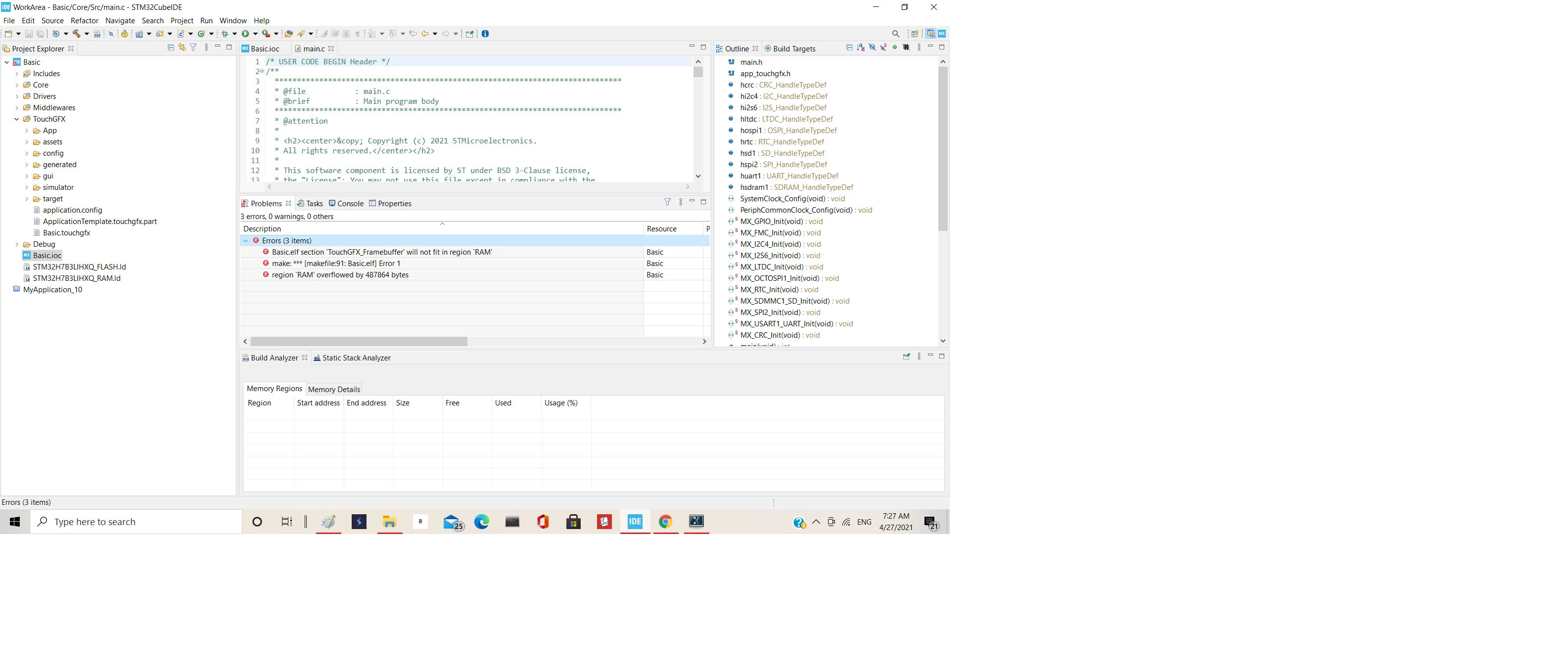

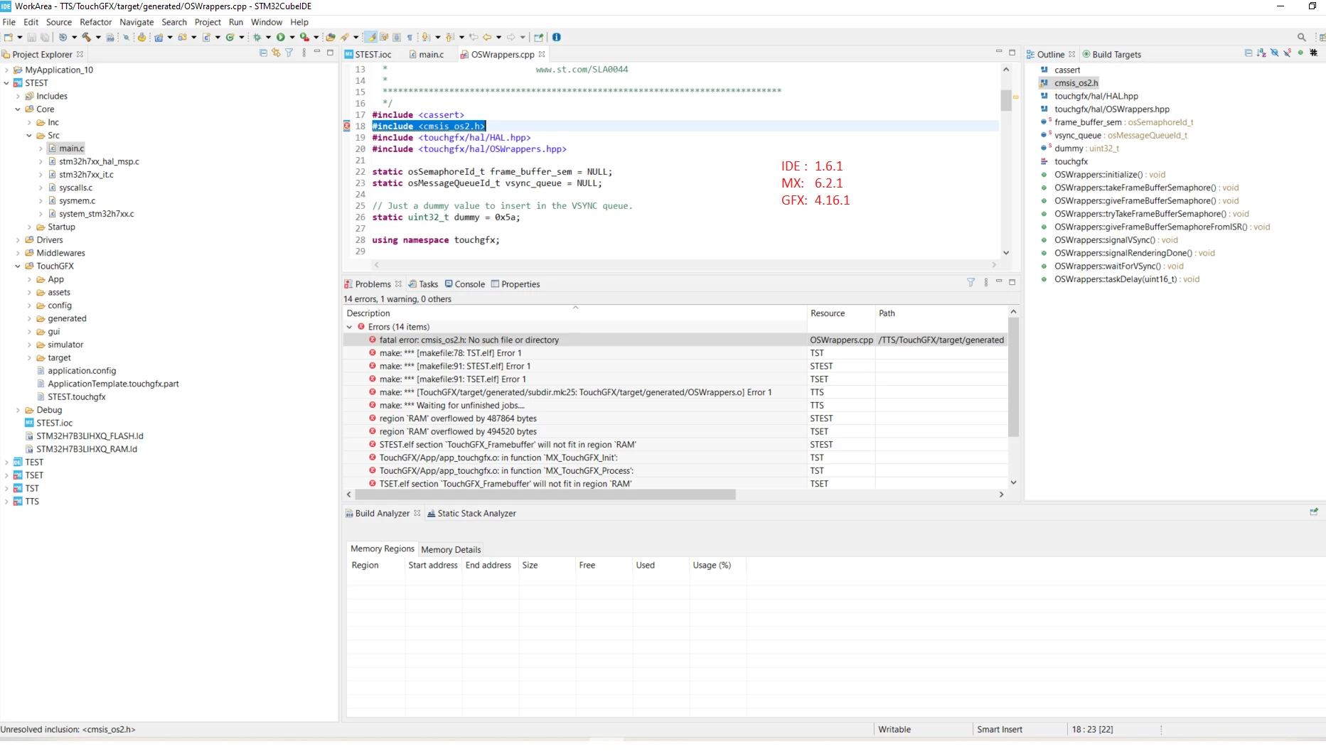

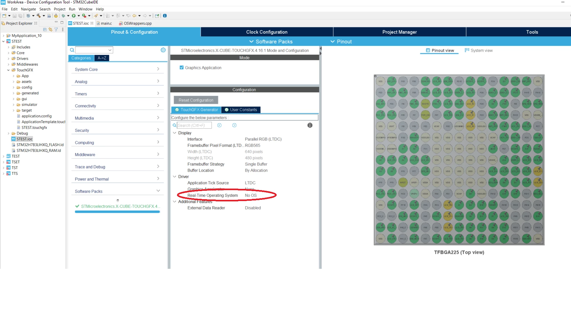

I tried a simple blank project (TouchGFX)for STM32H7B3I-DK first starting from IDE 1.6.1 and second time from MX v 6.2.1 but I've error fatal error: cmsis_os2.h: No such file or directory OSWrappers.cpp /TTS/. The MX configured for NO OS. attached

I tried again from scratch, this is what I got without adding a single line of code:(please find attached screenshots and RAM.ld file) .Help appreciated pointing out what is going wrong?

Do you wish to work with or without an OS ? If without, then get rid of the path to the cmsisos2 as this is meant for FreeRTOS.
/Romain

Thank you, @Romain DIELEMAN​ , it is working as follows:
1- start the project from TGX. designer 4.16.1
2- open the generated MX. 6.2.1
3- generate code from MX.
4- open project, IDE 1.6.1, build project is ok.
The question remains of the strange performance if I start the project from the IDE!
