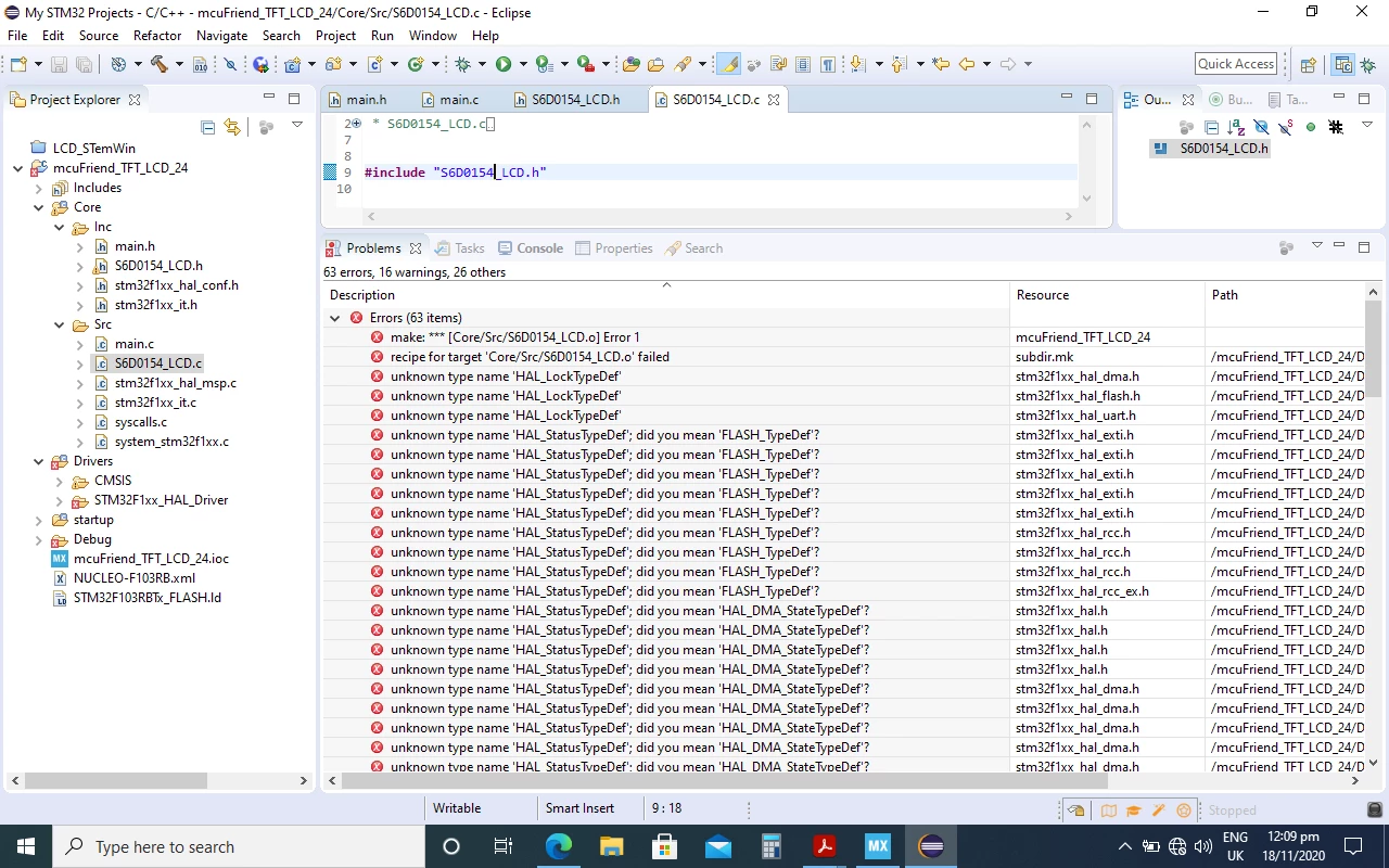

I receive no errors while compiling the header file( attached in details), for a LCD interface, but as I include this header in my .c file a lot of errors and warnings appear. I am new in c and HAL, kindly give some detail or reference for knowledge

KnarfB
November 18, 2020
A header file is never compiled, only included in .c files.
There are errors (red crosses) in the HAL driver libs. This should not be the case.
Generate a new, empty project without S6D0154_LCD. Check that it builds correctly. Then, insert S6D0154_LCD again.

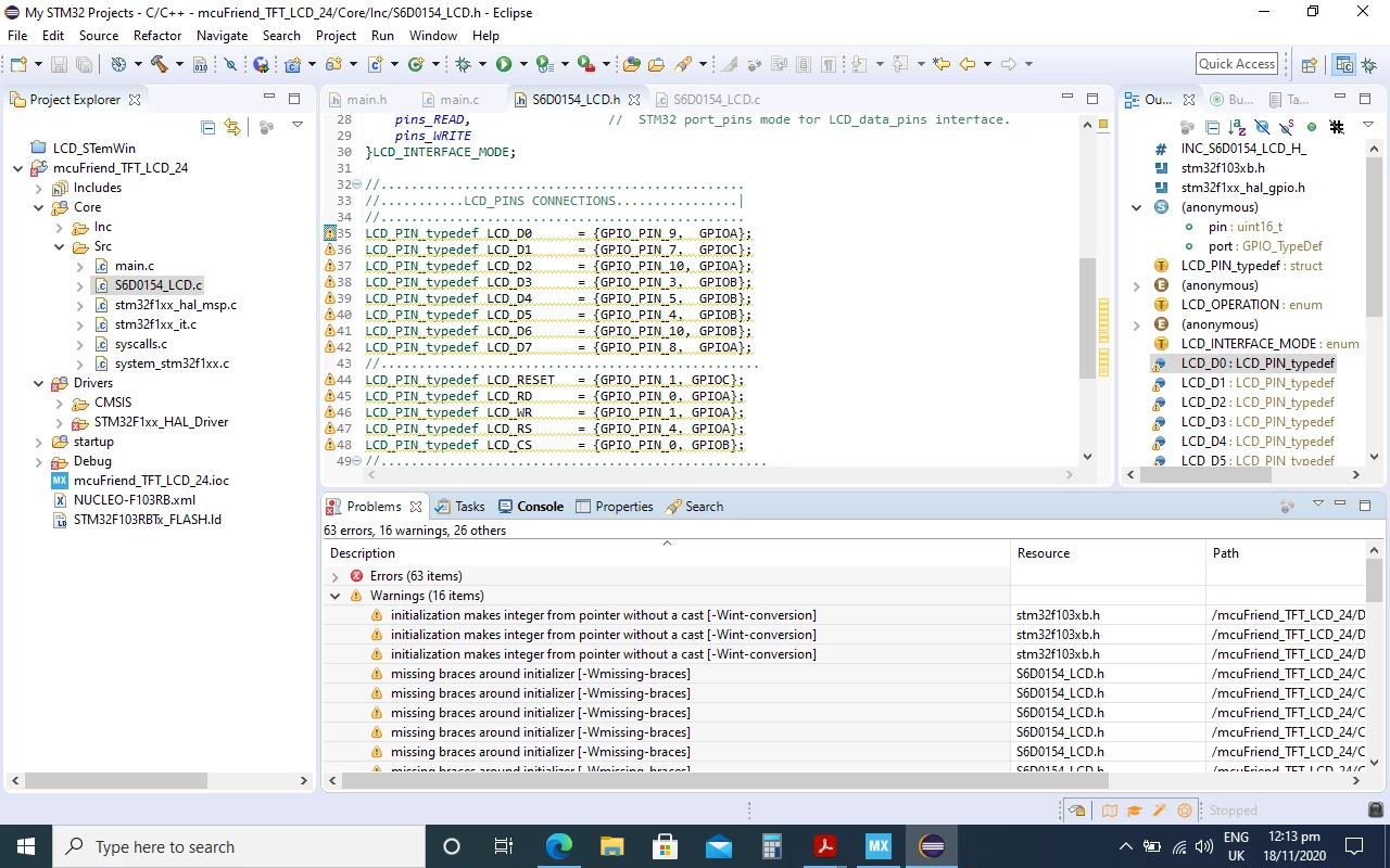

November 18, 2020
> #include "stm32f103xb.h"
> #include "stm32f1xx_hal_gpio.h"
You should only be including the first of these files. Everything else in included automatically based on your stm32f1xx_hal_conf.h file. Change the comments within the configuration file to include modules as needed.

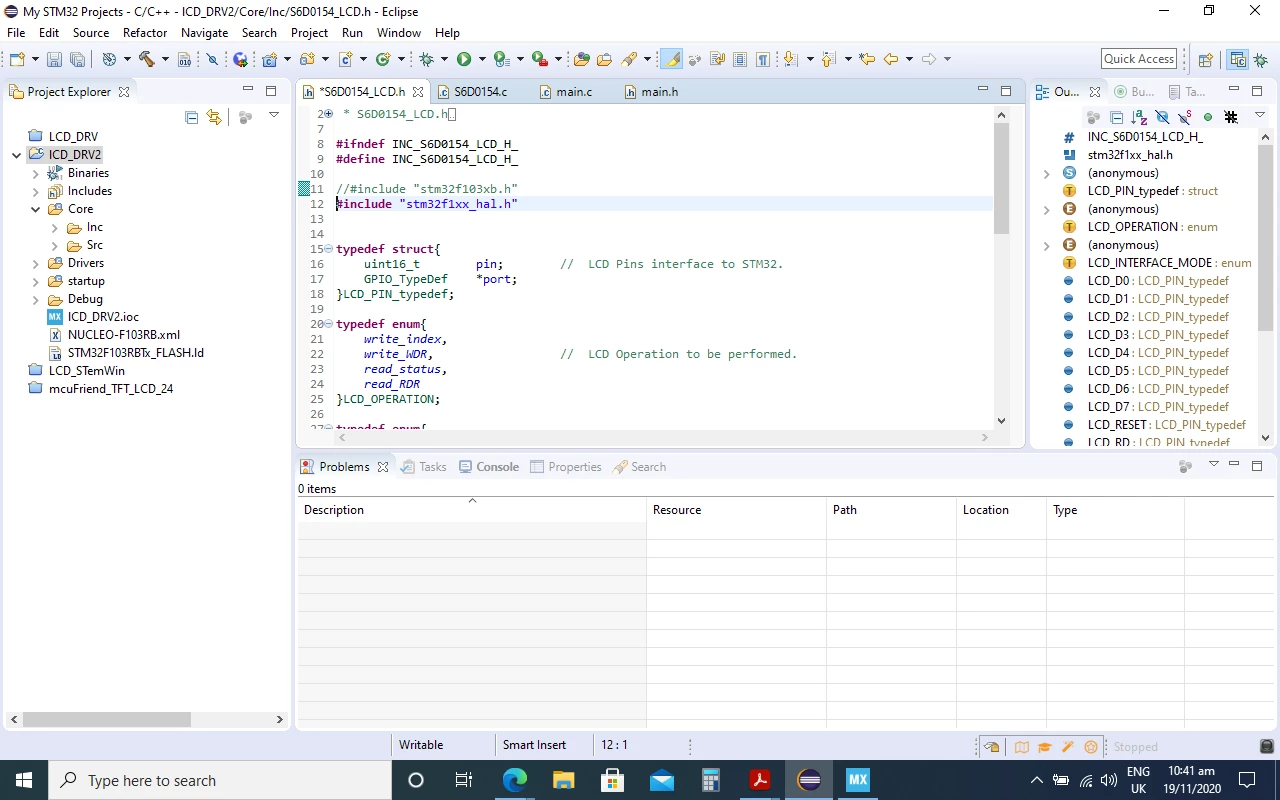

WRaso.1
WRaso.1Author
November 19, 2020
Including #include "stm32f103xb.h" in S6D0154.h produces symbol'GPIO_Pin_0' can not be resolved semantic error. Including #include "stm32f1xx_hal_gpio.h" resolve these errors in S6D0154.h file but compilation is not successful and strange errors appear in Core/inc folder. Instead of including stm32f1xx_hal_gpio.h I included stm32f1xx_hal.h file in S6D0154.h, now all the errors in S6D0154.h files cleared and project compiled successfully without any errors and warnings.
For me this was a fluke, Kindly give some guideline regarding including .h HAL files, (as I included stm32f1xx_hal_gpio.h to resolve "symbol'GPIO_Pin_0' can not be resolved semantic error", which resolved issues in .h file but project not compiled)0693W000005Bu0YQAS.png
November 19, 2020
I should have said you only include stm32f1xx_hal.h
Take a look at some example projects:
https://github.com/STMicroelectronics/STM32CubeF1/blob/master/Projects/STM32F103RB-Nucleo/Examples/GPIO/GPIO_IOToggle/Inc/main.h
