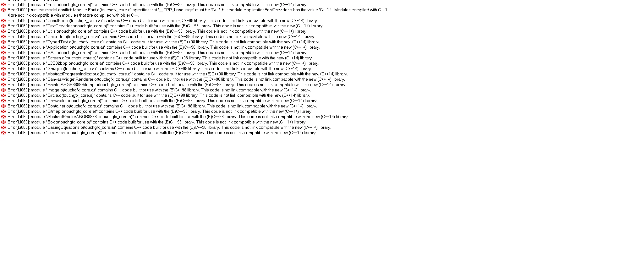

i'm using STM32H747XI and STM32CubeMX , TouchGFX. i did generated code using STM32CubeMX and TouchGFX . But code is not compiled at IAR 9.10.2. what can i do solve this?? Best regard. error is below..

Hello @ysuh.1​
STM32H7 package is compatible with V8.30.1 + ST-LINKV3 as mentioned in firmware release notes. IAR 9.X is not yet supported.
So, I think you have to switch the IAR version to 8.30.1 (and below).
