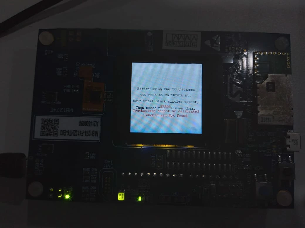

I'm using STM32F413H-Discovery board and having issue with mounted on-board touchscreen. I loaded example project BSP into the board but TS Demo 1, TS Demo 2, TS Demo 3 did not show output as expected. Please advise on how to solve this issue. Thanks

Hi @Community member​ and welcome to the Community :),
If you used the STM32F413H_Discovery_REVE board, please make sure to select the target board revision in the project options as mentioned in the stm32f413h_discovery.h.

Hi @KDJEM.1​ / Kaouthar,
Thank you for your reply.
I used STM32F413H-DISCO MB1274-F413ZHT6-E03.
I tried defined flag USE_STM32F413H_DISCOVERY_REVE in line 87 in the stm32f413h_discovery.h file but result shows same error.
Is there any other possible solution?

Hi @Community member​,
I confirm the issue: the STM32F413H-DISCO-REVE03 is not supported for BSP example.
In fact, the FRD154BP2902-D-CTQ LCD should use the BSP component ft3x67.
I reported this issue internally.

Hi @KDJEM.1​ ,
Is there any other example project that I can use to calibrate and test my touch panel for STM32F413H-DISCO-REVE03 board? or any example project with minor modification?
