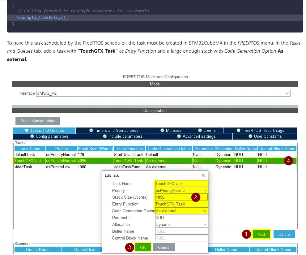

I've enabled FreeRTOS and have two tasks enabled, one blinking an LED that is working. The other set up for TouchGFXTask like the instructions.

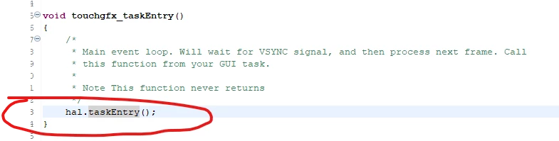

0693W00000Y9ypSQAR.png Which creates the task, I can follow it into app_touchgfx.c, and on to TouchGFXConfiguration.cpp
0693W00000Y9yqGQAR.pngThe hal.taskEntry() takes me to HAL.hpp. No where else.

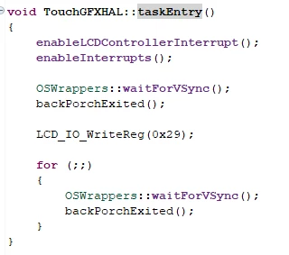

Looking at another example the hal.TaskEntry() goes to TouchGFXHAL.cpp and has code:0693W00000Y9yquQAB.pngWhat should be at hal.taskEntry()?

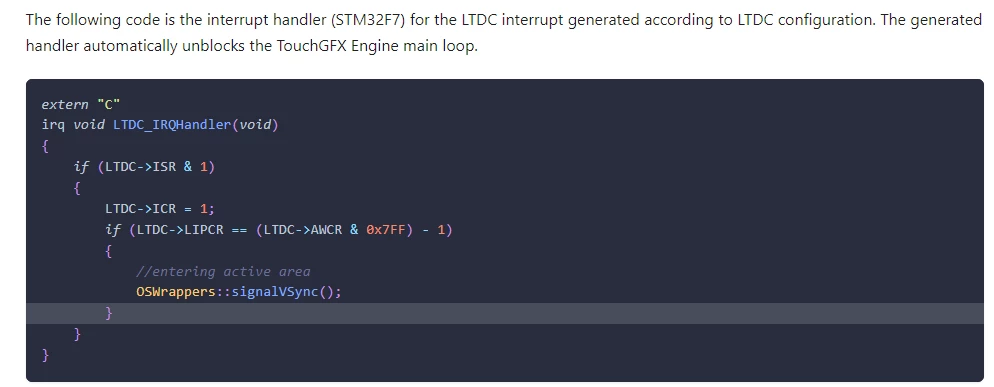

The instructions also reference the LTDC_IRQHandler again. I don't find this section of code below anywhere. Should I add it and if so where? Now that I have enabled FREERTOS, the LTDC_IRQHandler in stm32l4xx_it.c doesn't get raised.
0693W00000Y9yrdQAB.pnghere:
https://support.touchgfx.com/4.21/docs/development/touchgfx-hal-development/scenarios/scenarios-ltdc-parallel-rgb
Are there some steps that I missed to get the LCD to show what I have built in touchGFX?

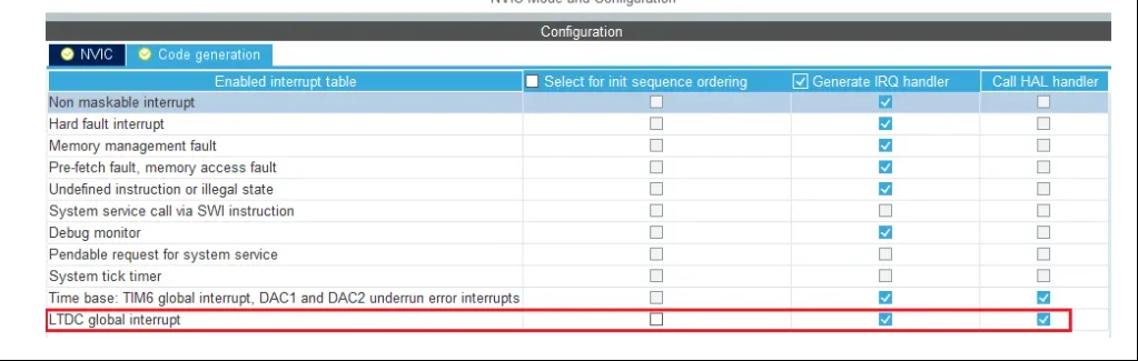

NVIC is enabled like the screen shot below. The interupt was getting called before I enabled FreeRTOS.
0693W00000YA4wQQAT.pngI checked vsync and hsync with scope the signals look good.

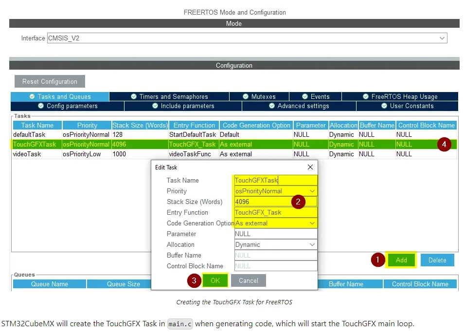

After I setup FreeRTOS like this:
0693W00000YA53vQAD.pngI can drill into the task it created,
0693W00000YA5MwQAL.pngto hal.taskEntry(), there is no code / function for hal.taskEntry(). Shouldn't TouchGFX have generated the code?
