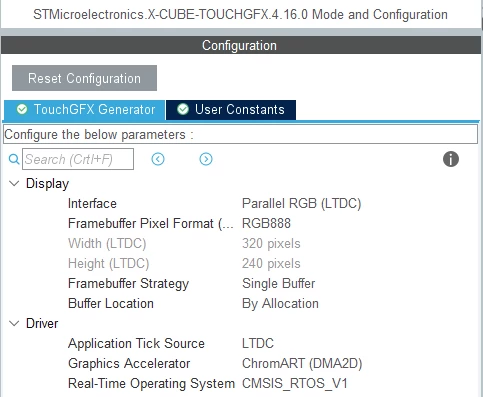

I'm not able to use RAM_D2 section in STM32H743 as frame buffer
Everything is working fine having the framebuffer in RAM_D1 (0x24000000).
This is what I have done trying to move my frame buffer to RAM_D2 (0x30000000):

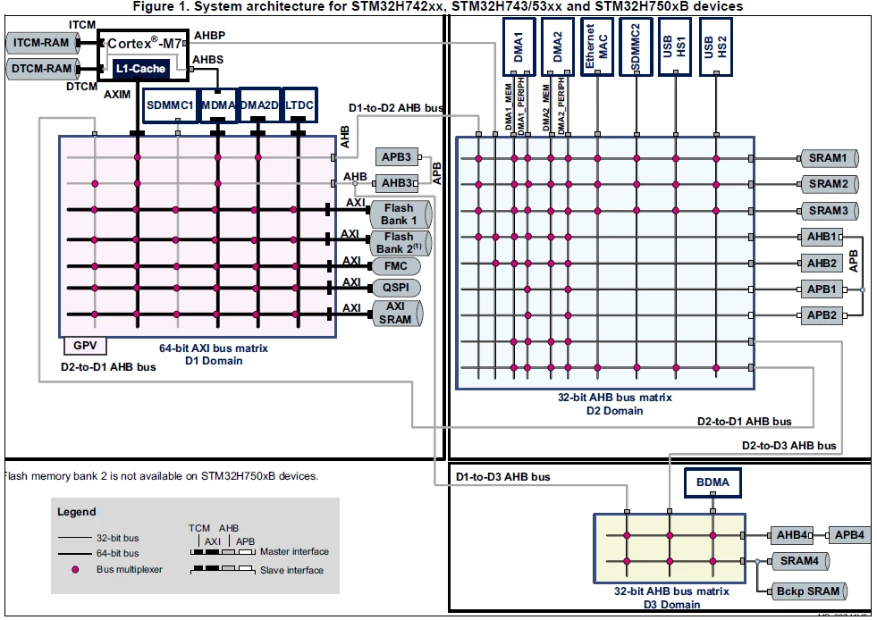

This https://community.st.com/s/article/FAQ-DMA-is-not-working-on-STM32H7-devices pointed me to the conclusion that this is not possible.
The DMA2D can copy data from QSPI to RAM_D2 (this I can confirm from debugging) but the LTDC can not take data from RAM_D2 because there is no connection between them. And therefor using RAM_D2 for frame buffer is not possible on STM32H7. Take a look at the memory architecture below.
Is my conclusion correct?

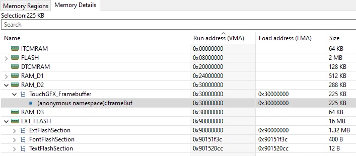

0693W000006I1qhQAC.pngI can confirm that the RAM_D2 is working, I can read and write to the RAM_D2 area.
The frame buffer is setup to use RAM_D2 address @0x30000000.
But the screen is black, nothing is showing up on the screen...

The frame buffer contains the same data in both cases, so it seams like it's not capable to push data to display when it's in the RAM_D2 area.

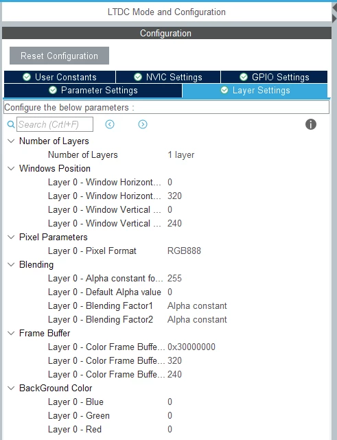

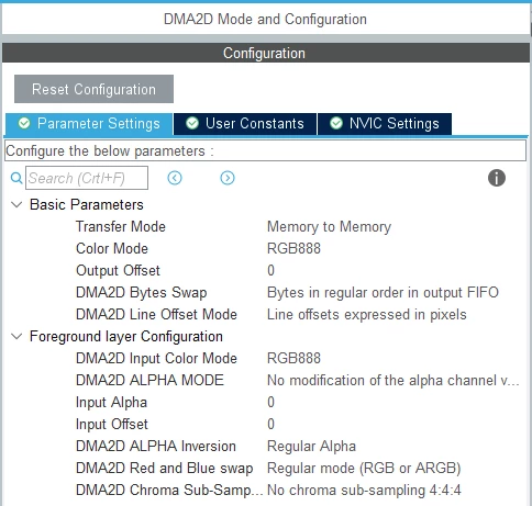

I use the STM32H743ZI on a custom board and I use parallel interface LTDC with ChromART (DMA2D), pixel format RGB888.
When I debug I can se that the LTDC frame buffer CFBADD is set to 0x30000000 (RAM_D2) and also the DMA2D memory address MA is also using the RAM_D2 (0x30000000 to 0x30038400, frame buffer size 225K).
The application is running fine (except for there is no picture on the LCD) and also if I have the application to change the screen picture I can see the RAM_D2 (0x30000000 to 0x30038400) content is changing.
Remember the only thing I have to do is change which RAM (RAM_D1 or RAM_D2) in the linker where the frame buffer (TouchGFX_Framebuffer) shall be, and using RAM_D1 it works fine!

MM..1
Jan 13, 2021 8:15 PM UTC
Yes when isnt RAM_D2 accessible over AXI SRAM , then you have right about LTDC. Otherwise MPU is boss.
