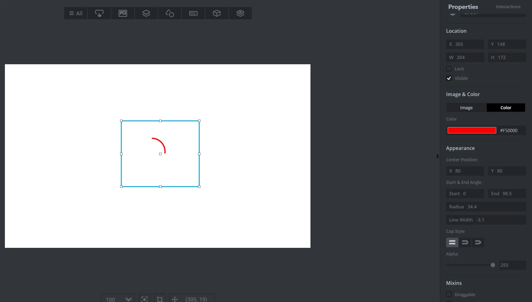

I have to create a widget, which is a "segment of a circle" .
  • January 30, 2023
  • 1 reply
  • 675 views
I created a circle by clicking "shapes -> circle". Defining this circle by telling the "Start & End Angle" I get a widget which has the outlines going from the corner described by the start angle, via the center of the circle, to the corner defined by the end angle. In other words I got a circle which is cut out by a "V". I need a "segment of circle". This would be possible if the outline is going directly from one corner to the other, skipping the point between (the center of the circle). I am missing the possibility of deleting one point of this widget like it is possible for free "shapes". Is there another way which I have not noticed?

Hello TLang.5,
You can have a segment of your circle easily by putting a positive or negative value to your "Line Width" as shown on the image bellow (just need something else than 0) :
/Osman
