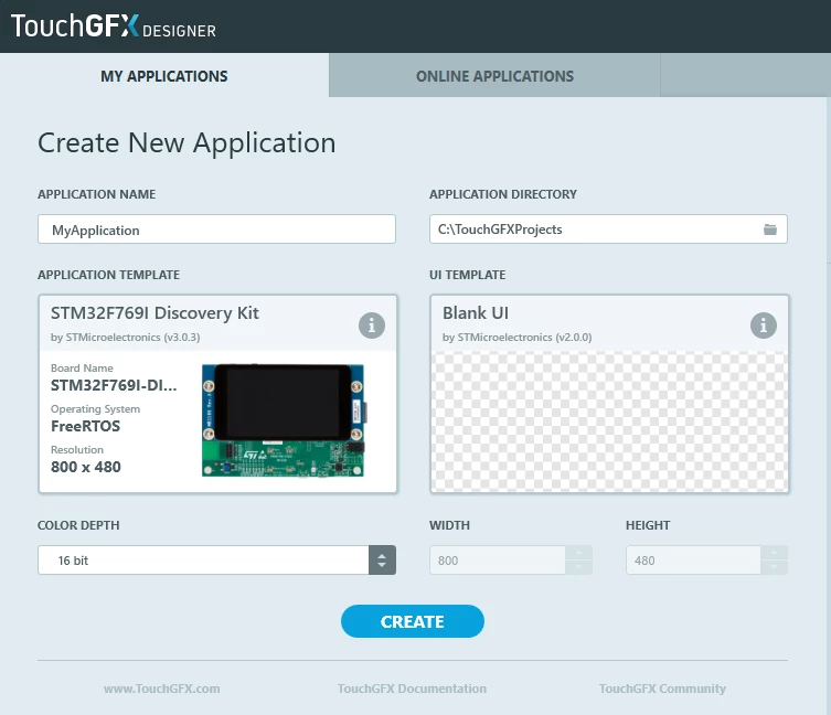

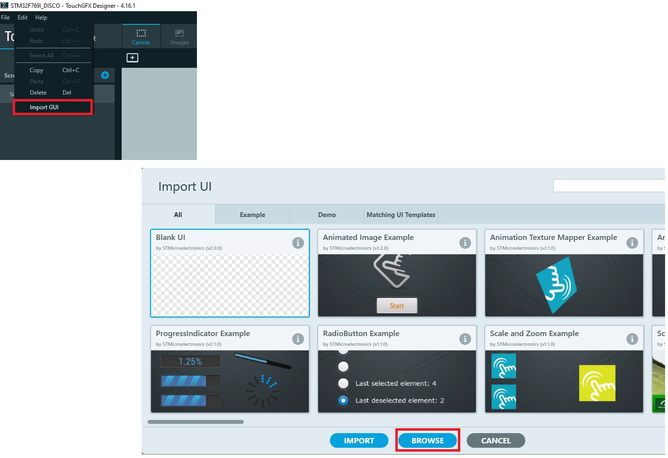

I have developed a project in PC Simulator but now I got the STM32F769I-DISCO kit. Now can i able to run the same project to this target? I tried to added Target commands in Config Build. but it not running. How should i do it?

Best answer by N. SANTINI
You need to create a new project using the STM32F769-Disco application template and empty GUI template.
0693W00000BbZB2QAN.pngThen use the menu "Edit->Import", then "Browse" and select the .touchgfx file of your simulator project.
