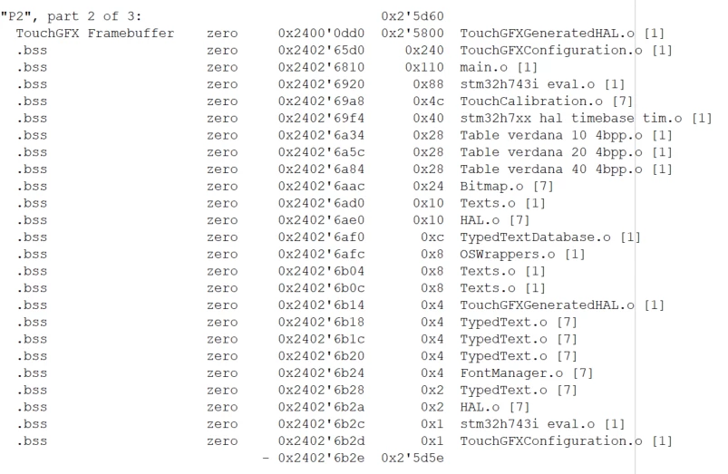

I have a project to display some text using touchgfx. I'm using a custom H750 board, a LCD-TFT display. My LTDC, DMA2D, SPI is working fine but when i try including touchgfx, every time the framebuffer gets zero.
  • May 4, 2020
  • 10 replies
  • 4956 views
 I'm not using rtos, my touchgfx process is included in while(1). After debugging through IAR, i've run it and below image is from the .map file. I've also checked the memory address, it is getting zero only.0693W000000WouwQAC.png

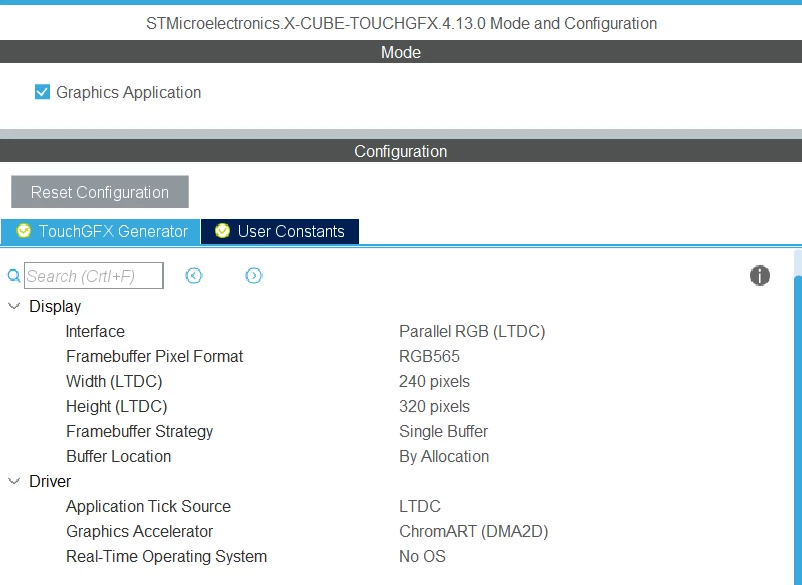

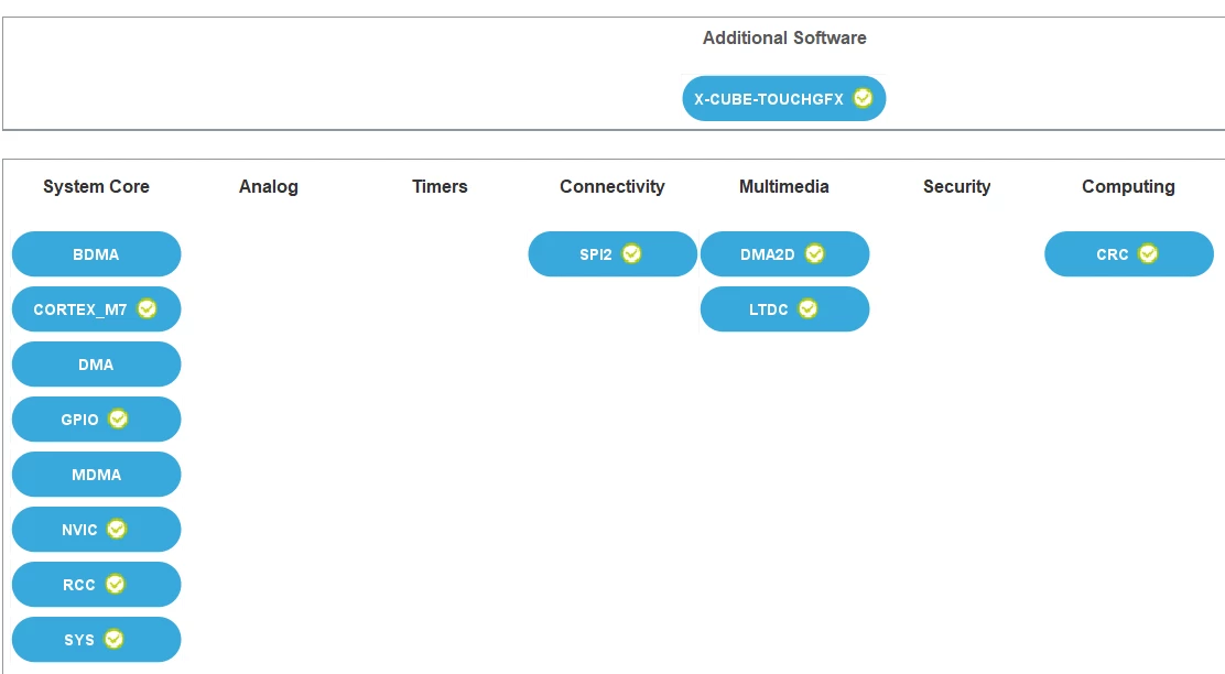

Hi Martin,
I started this project from CubeMX for IAR. From CubeMX, i initialized the below mentioned. I can display some image or text by directly putting an array into LTDC Framebuffer start address. But i need to use TouchGFX for my design. I'm not using RTOS.0693W000000WqCIQA0.png0693W000000WqCDQA0.png

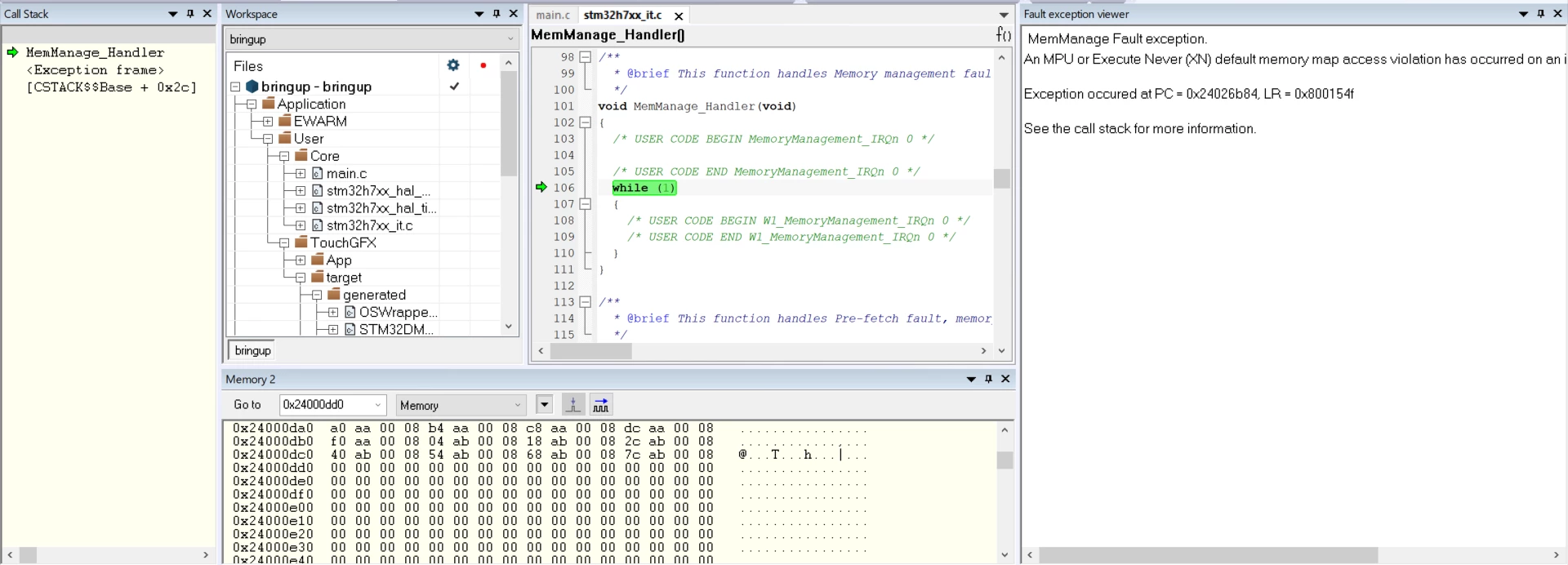

If you pause your program and inspect the framebuffer, nothing is there?
biki
bikiAuthor
May 5, 2020
No it is always zero. If i pause it, it is going to hardfault handler.0693W000000Wtb6QAC.png

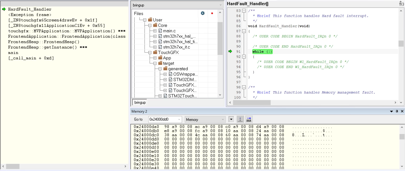

May 5, 2020
I was commenting out CRC_Init(), Now i removed the commenting and this new fault is coming up0693W000000WtdWQAS.png
Martin KJELDSEN
Principal III
May 5, 2020
Okay. TouchGFX is CRC-locked to STM32 so commenting that out is a bad idea :)

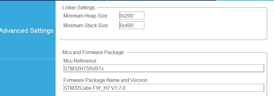

Check your freertos mem strategy, size of stack and heap.
/Martin
biki
bikiAuthor
May 5, 2020
I'm not using freertos at all. In the driver section you see "NO OS". I want to create this project without RTOS. I didn't change the default stack and heap size.0693W000000Wu8PQAS.png0693W000000WqCIQA0.png

Sorry, forgot you werent :) Check your fault registers to find out what kind of fault this is.
biki
bikiAuthor
May 5, 2020
I'm getting this memory management fault. An MPU or Execute Never (XN) default memory map access violation has occurred on an instruction fetch (CFSR.IACCVIOL, MMFAR). Exception occured at PC = 0x24026b84, LR = 0x800154f . I don't have an external memory so i'm using "stm32h750xx_flash_rw_sram1.icf"
