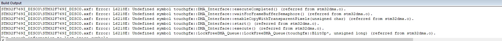

i have a problem when i am using touchgfx generate code for Keil.
  • June 15, 2021
  • 4 replies
  • 2087 views
0693W00000Bb0pbQAB.pngI have stm32f769 discovery board and i want to use it's LCD. at first i choose stm32f769i discovery kit in touchgfx: application template. i design my user interface and generate code. when i press Run Target, the lcd of my board is programmed and works well. now i want to add some peripheral to my project. like uart, interrupt and ... .because of this i need to open the project in keil. i open the keil project that touchgfx has made. but i can't build it.
when i want to build project i get some errors like in the picture. what should i do?
thans for your help

Romain DIELEMAN
June 15, 2021
Just to be sure, did you change the toolchain to MDK-Arm in STM32CubeMX and regenerate code from STM32CubeMX and then from TouchGFX Designer ?
/Romain
ahmad.karimi71
June 17, 2021
hello. sorry. i didn't undestand you. you mean after generate code from touchgfx, i should open cubemx file ( .ioc file that touchgfx made it) and regenerate code from stm32cubemx for mdk-arm and after that regenerate again from touchgfx designer?
you mean this flow graph?
design UI with Touchgfx >> generate code with touchgfx >> open cubemx file ( .ioc file that touchgfx made it) >> regenerate code from cubemx for mdk-arm >> regenerate again with touchgfx
thank you
Romain DIELEMAN
June 17, 2021
Yes this is what I meant. Without this step you will not be able to run a project started from an application template with another toolchain than STM32CubeIDE as explained in the link I shared.
/Romain
