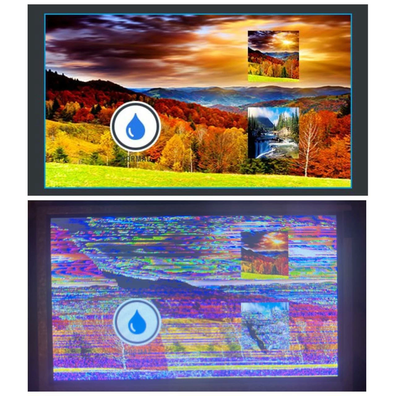

I have a problem in my TFT LCD project. I use LTDC, FMC, SDIO, and Touchgfx. I read all of the images in stm32f429 from the SD card. some of the images in my project don't load correctly. what should I do? and what is the reason?
  • September 6, 2022
  • 1722 views
0693W00000Subh1QAB.jpgas shown in this picture (the top picture is in Touchgfx and the bottom picture is in my LCD board) some images in my LCD don't load correctly!
my code :
void StartDefaultTask(void const * argument)
 /* USER CODE BEGIN 5 */
 f_mount(&SDFatFs, SDPath, 0);
 f_open(&MyFile, "image_icon_center_normal.bin", FA_READ);
 size = f_size(&MyFile);
 res = f_read(&MyFile, (void*) 0xc0139200, size, (UINT*)&bytesread);
 f_close(&MyFile);
 f_open(&MyFile, "image_bg22.bin", FA_READ);
 res = f_read(&MyFile, (void*) 0xc00f9600, size, (UINT*)&bytesread);
 f_close(&MyFile);
 f_open(&MyFile, "image_bg2.bin", FA_READ);
 res = f_read(&MyFile, (void*) 0xc00f3200, size, (UINT*)&bytesread);
 f_close(&MyFile);
 f_open(&MyFile, "image_bg0.bin", FA_READ);
 res = f_read(&MyFile, (void*) 0xc00f0000, size, (UINT*)&bytesread);
 f_close(&MyFile);
 MX_TouchGFX_Process();
 /* Infinite loop */
 for(;;)
 osDelay(1);
 /* USER CODE END 5 */

dibadigital
October 26, 2022
My problem is solved. The reason was that the image was corrupted. In fact, I had changed the resolution of an image with paint, and it was broken. I had to change it with Photoshop.
