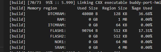

I can't save images on external Flash Memory correctly

I have a custom board with STM32H7A3 using FMC, LLTC and other modules. I started to develop the firmware to change some images in a display. I made one project on TouchGFX with multiple images and fonts. I verify the BitmapDatabase.cpp and the all images files generated. For each image file generated for example:
LOCATION_PRAGMA("ExtFlashSection")
KEEP extern const unsigned char image_attention_all[] LOCATION_ATTRIBUTE("ExtFlashSection") = { // 223x265 RGB888 pixels.
 0x0b, 0xba, 0xf7, 0x0b, 0xba, 0xf7, 0x0b, 0xba, 0xf7, 0x0b, 0xba, 0xf7,
In my application.ld file I put that configurations that I view on https://support.touchgfx.com/4.18/docs/development/scenarios/using-non-memory-mapped-flash
/* Specify the memory areas */

When I try to build the program I have section output from compiler:
0693W00000KZdXTQA1.pngWhat I'm doing wrong?

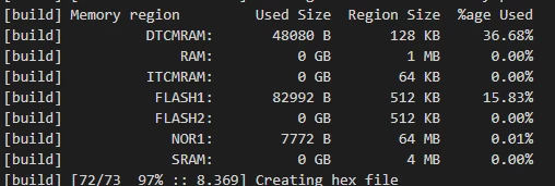

I only can write some program inside NOR1 when I change part of linker like:

0693W00000KZddqQAD.pngWhat am I doing wrong? How can I have a sure that I write all images files in External Flash?

Best answer by MM..1
Your one image have around 170kB and isnt on any area linked, then error is in your makefile.

Are youy sure, that build is over images cpp files ?
And i see one problem
NOR1 (rx) : ORIGIN = 0x60000000, LENGTH = 64M /*External NOR Memory*/
SRAM (xrw) : ORIGIN = 0x62000000, LENGTH = 4M /*External SRAM Memory*/
64M ends override SRAM section +32M

MM..1
MM..1Best answer
February 18, 2022
