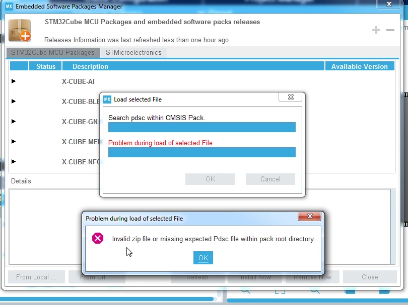

Hello!
In this menu
I can't see X-CUBE_TOUCHGFX.
I downladed it from ST.COM, but when I try to install zip, I see message
How to install X-CUBE-MX???
Best answer by
Hello!
Firsrt screenshot is not my screenshot, isit is from your article.
I put it to show place, where problem located.
But now I have solved problem. It was because my Windows has username with cyryllic letters. I set it to non-cyryllyc, and cubeMX begun work well, like on the first screen.​

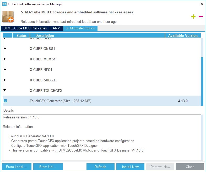

Not being able to install the zip is weird, i'll look into that.
But, in the first screenshot you're pointing to X-CUBE-TOUCHGFX. Can't you press "Install now" ?
/Martin

Hello!
