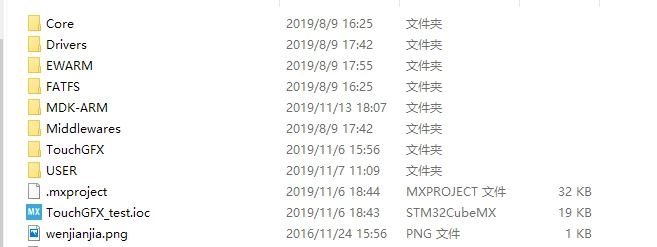

Here is my project. In this project , I can not create the binary_fonts with using the TouchGFX designer 4.12.3.
Martin KJELDSEN
Principal III
Nov 19, 2019 9:38 AM UTC
Check the TouchGFX folder?
/Martin
