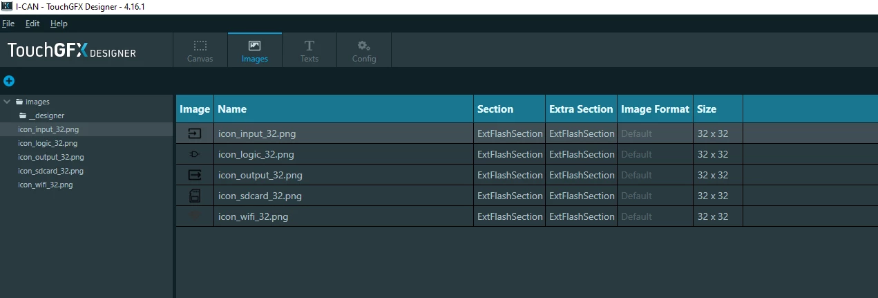

I am working with a custom board: I have a Touchgfx project that seems to work fine with my custom loader, but if I place text in the external flash it will hard fault. Please note that when I place images/Icons it works fine.

it compiles and runs fine. the only problem I am having is placing the TouchGfx text resources in the external memory. The icons/images are also on the external flash. it works with the icons on the external flash, but when I modified the linker to place the texts on the external flash is when I start having the hard fault issue.

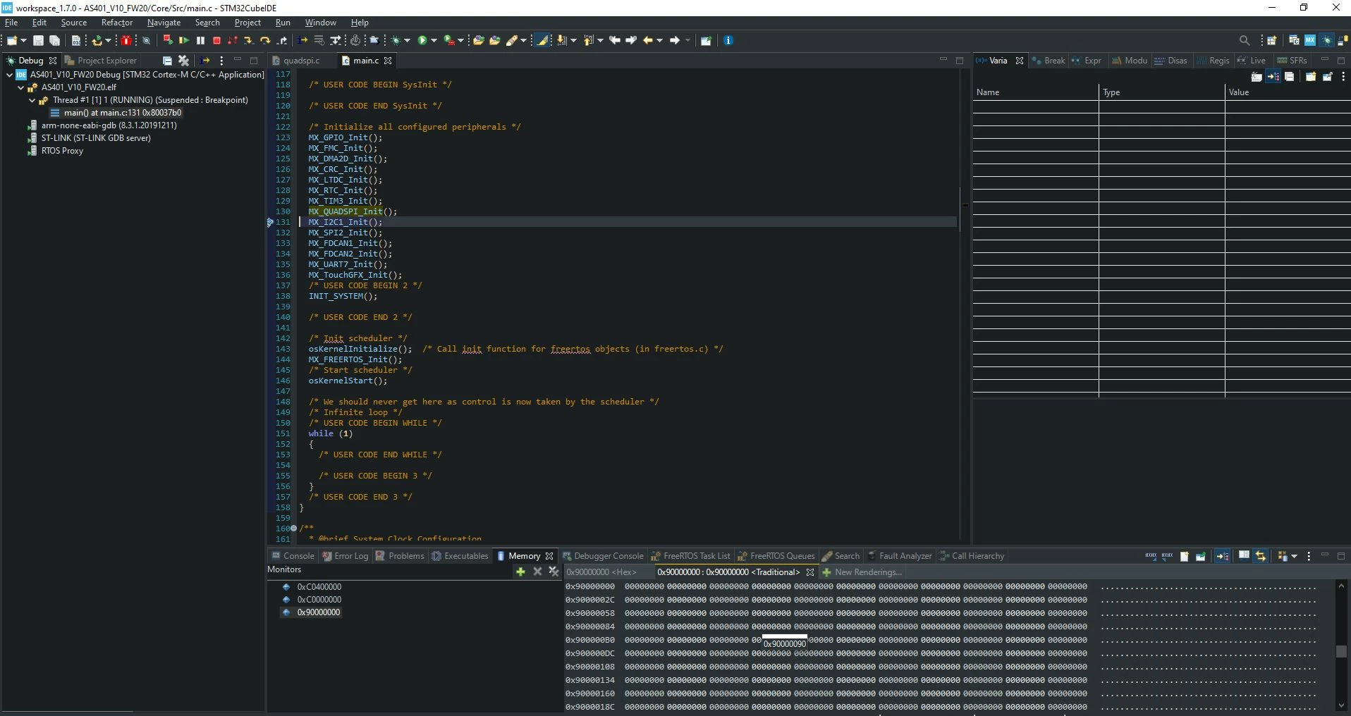

Oct 31, 2022 3:14 PM UTC
If You have hardfault when start then problem is with reading external memory.
When You start debugging after initialization QUADSPI do You see contents memory? (see picture from my project).0693W00000VOW5AQAX.jpg
