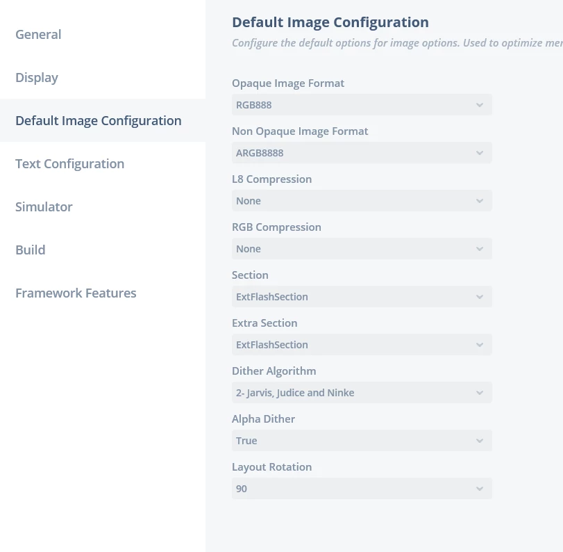

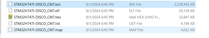

I am using TouchGfx on STM32H747I-DISCO board. My final binay size is 2.13 GB
  • September 1, 2024
  • 6 replies
  • 2119 views
Default Image Configuation setting is :

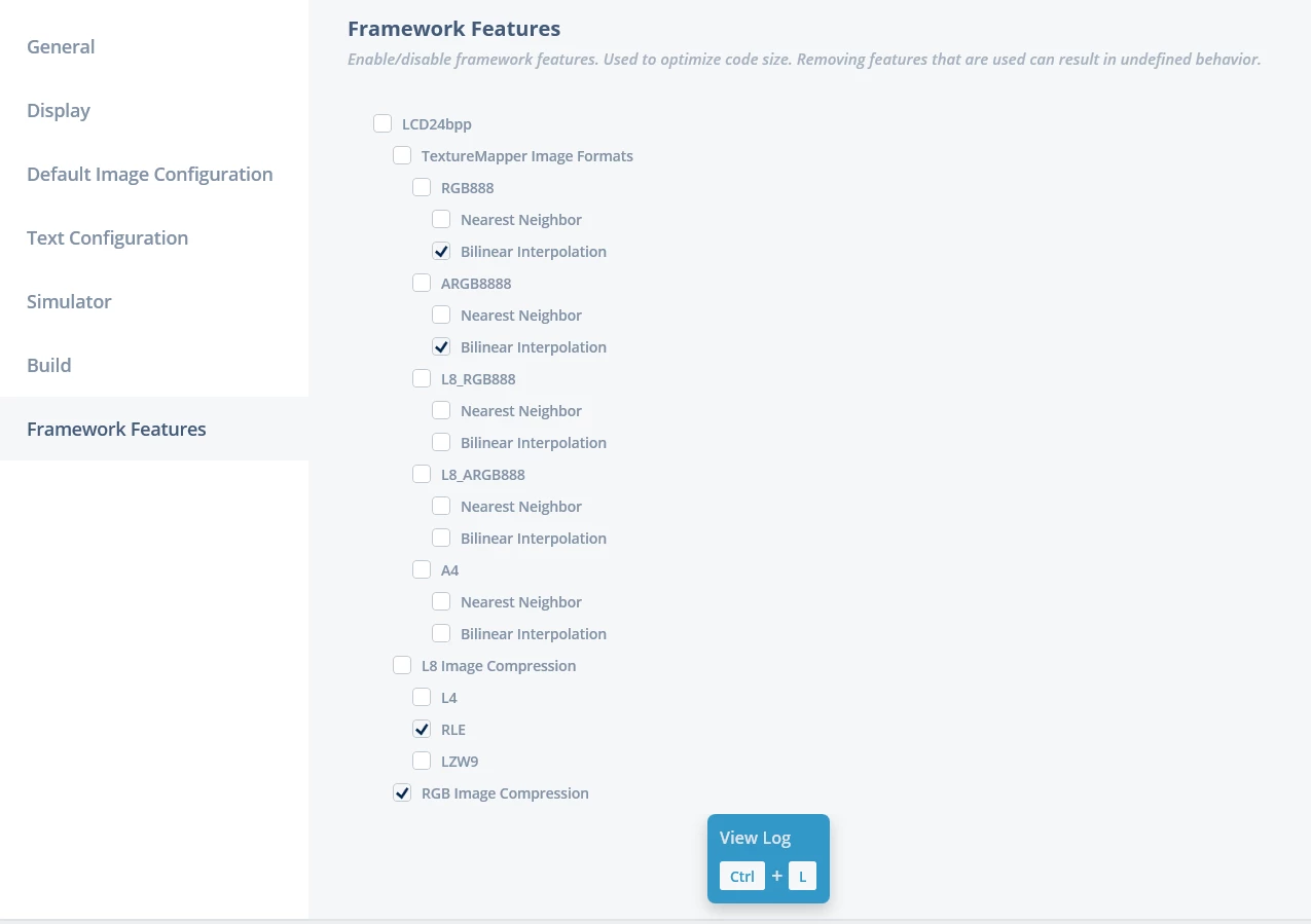

Framework Features:
Size of .bin file

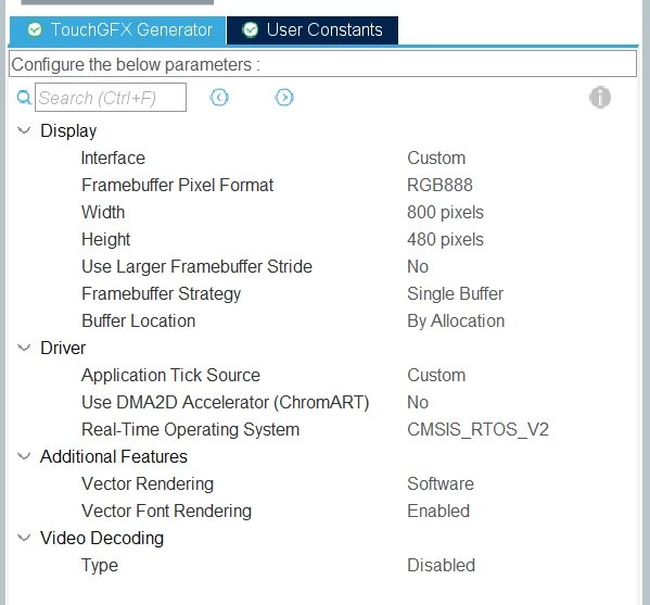

Touch Gfx setting in IOC file:

Don't use a .BIN to describe two regions with large separation within the ARM's 4GB address space.
Use a .HEX, or divide into two or more .BINs describing the 0x08000000 and 0x90000000 regions separately.

We made a video about reducing flash size : How to TouchGFX: Save flash memory
You could also check your compiler setting to reduce size (-Os for size optimization in GCC).
