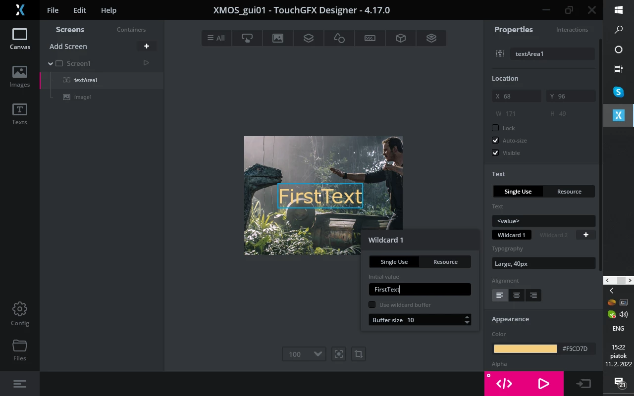

I am using STM32F769I-DISCO board for interfacing 4 inch TFT LCD display MB1166 using I have used TouchGfx tool to send text on the display. Now to i want to write the customized code to send a string on the display. Pl tell me procedure.

Thank you so much for such a prompt reply. I don't have .setWildcard this member any where in the code. What should I do now?

Add wildcard part to text area
