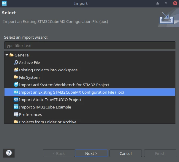

hello, lets try... (i must go now, back in 1 h ) in short:
  • unpack the zip
  • now in Cubeide we import ...file->import->from ioc (i am not shure - maybe import cube example works also, but first we try this)
  • give name etc as needed (project/path names without spacec or special signs)
  • then import file-> file system -> from directory ... separate, first for .c files
  • then same import... for .h files
  • now you should have working project (about target directories- look at other project, that you make with ide , how there are the directories)

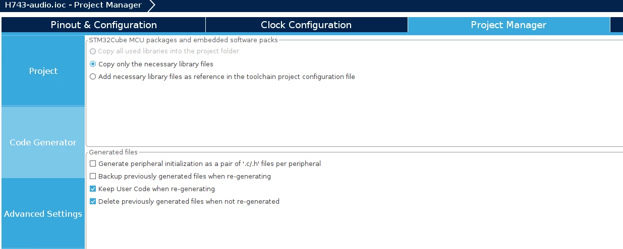

AScha.3
March 11, 2023
> have to manually copy code
no. read my post - you have to import...from file system . only this way the ide "knows" which files are in this project.
to see whow it should be :
  • make new project // file -> new stm32 project
  • select a cpu from list (maybe the cpu or board you have)
  • give it a name (F429-test-V0 or whatever)
  • finish
  • click / open the cube (Ioc) , where you see the chip/pins etc.
  • open project settings and set > generate...pair c/h files
  • then set something in the chip active (debug on, adc on some pins...)
  • then click gear wheel, generate code.
  • now you left side the files and directories, the way this ide wants it
  • now make next project, with start from ioc import
  • do same ...ini pair of c/h .. setting
  • generate code
  • now import the c and h files with file-> import-> from filesystem... to the correct directories.
  • now it should work... (to replace main.c +/.h , close ide and replace manual the main.c/h files to same position as they are in ide files; then start ide - now has this new main files there. )
