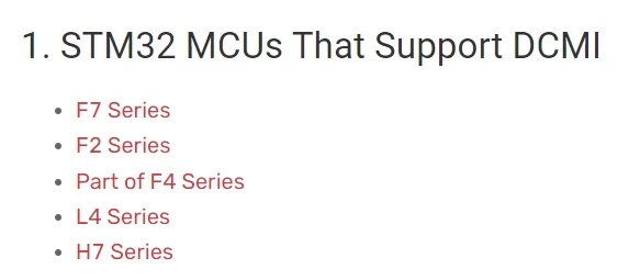

I am looking for the suitable development kit for interfacing my 'camera sensor' through parallel interface. The board should include HDMI, USB as well to display the image through to end terminal. Which STM32 dev. board I should look into?

what I mean is that I am looking for a 'ST development board/kit' which can support 'qvga ir camera parallel interface' and provide the HDMI/USB/LAN ports to display as per the further connectivity. what I found out is that DCMI functionality supports the 'camera parallel interface' and few MCUs which supports DCMI from here https://www.arducam.com/stm32-cameras-that-support-dcmi/ since I am new to this, I didn't find out the proper suitable 'development kit' based on these MCUs which meet my requirement and simple in development as well. Please suggest if any. Thanks.
