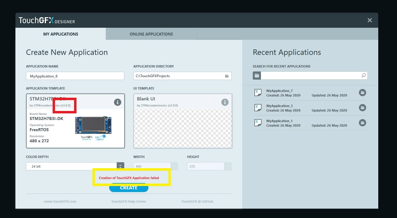

I am getting error like "Creation of TouchGFX Application failed" while click on "CREATE" button
  • January 9, 2020
  • 5 replies
  • 2656 views
Hello Sir,
Since, Last 1.5 months i am working with TouchGFX.
I am getting error like  "Creation of TouchGFX Application failed" while click on "CREATE" button.
Can you please guide me for same.
i have check my internet connection is working fine.
please do needful for me.
Thanks in advance.

Hi @Community member​,
Please download the newest version of TouchGFX Designer (At the time of writing it is 4.13.0), this should fix the issues for Application Templates of version 3.0.0
https://www.st.com/en/development-tools/touchgfxdesigner.html
Best Regards
Anders
Martin KJELDSEN
Principal III
January 9, 2020
There's an issue with older versions of TouchGFX Designer being able to access Application Templates that are incompatible for that version. While the information for these new application templates reflect the appropriate version you'll still be able to "CREATE" and fail.
If you update to 4.13.0, as Anders mentions, you'll also be able to open this project in CubeMX 5.5.0 and use the new TouchGFX Generator to customize your HAL.

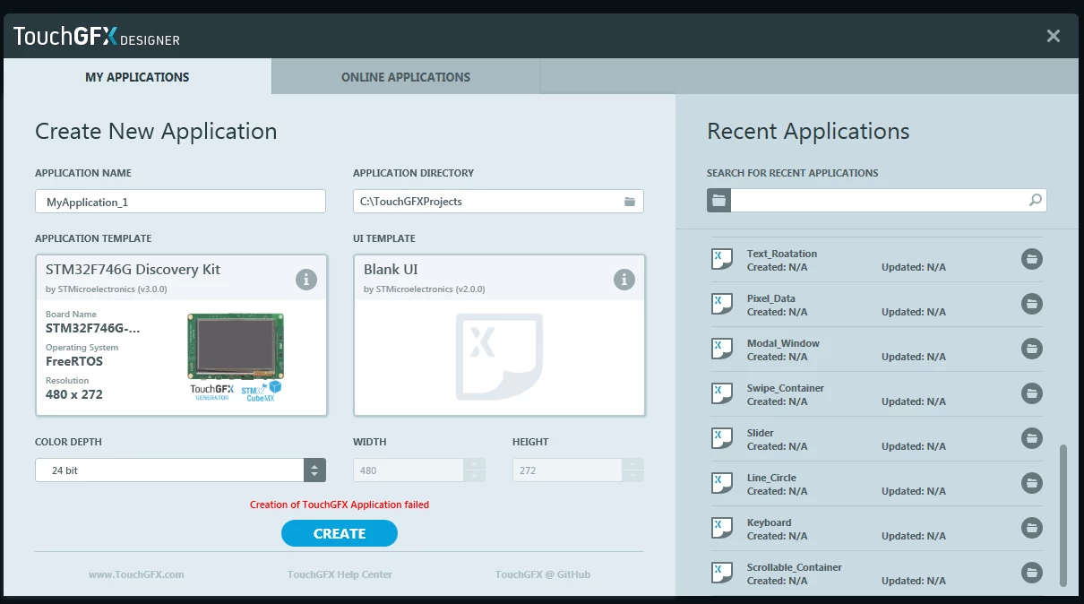

setup on Windows 10
TouchGFX 4.12.3 Designer

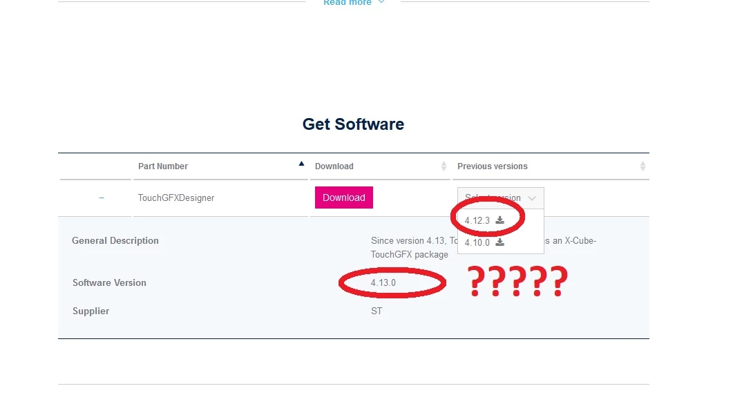

Hi to all, anyone can help me?
Thank a lot
Francesco

I don't understand your highlighting - "Previous versions" do not include the "current" version.
Please show me a log file %APPDATA%/TouchGFX-4.13.0/TouchGFXDesigner.log
fpolicastrese
Visitor II
May 28, 2020
Hi Martin, thanks for your answer.
I solved it by installing the TouchGFX-4.13.0.msi version, this version are only present in en.x-cube-touchgfx.zip package.
Regards.
