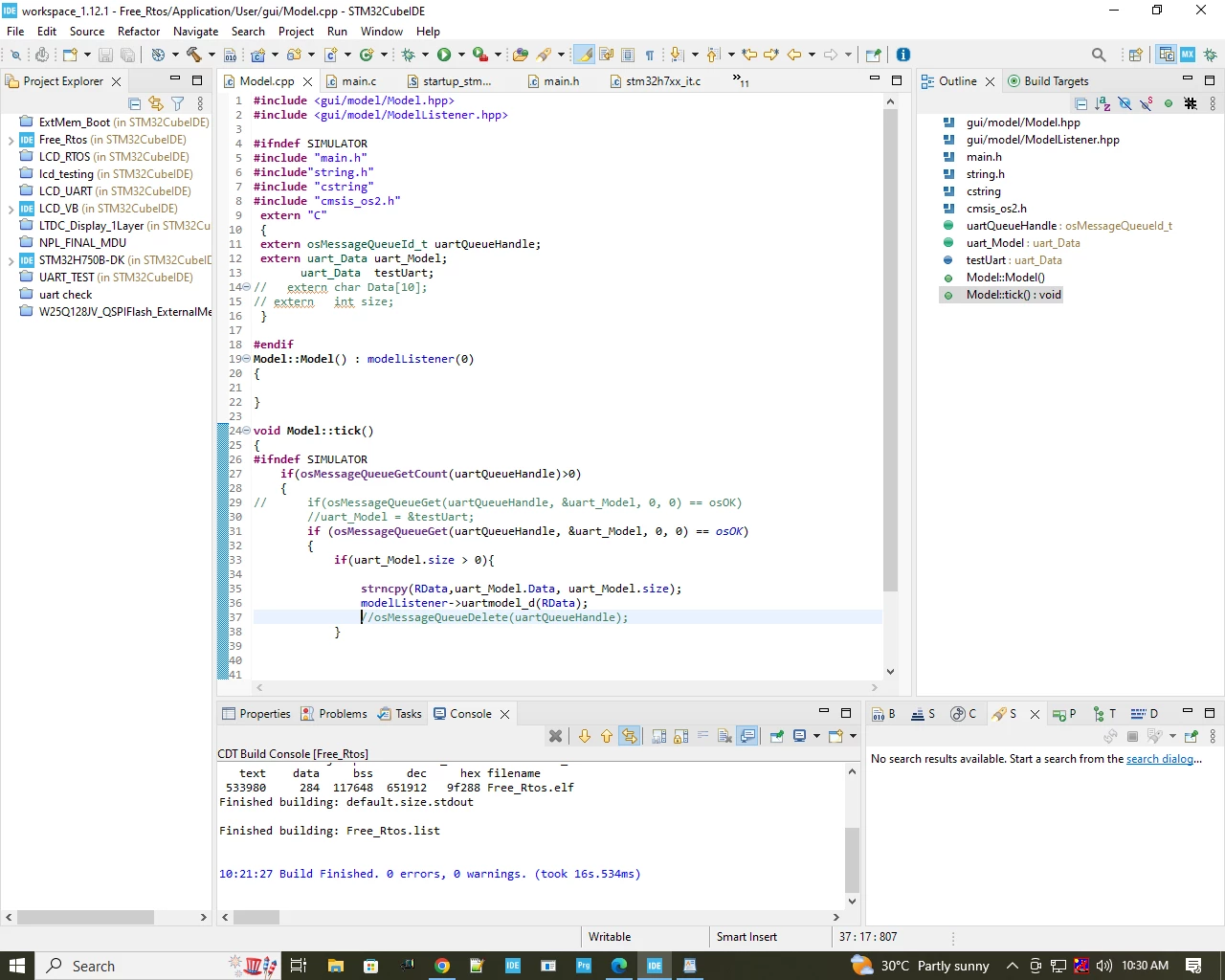

I am currently facing the issue with continuously displaying UART data on LCD using TouchGFX
I am currently working on the STM32H750VB custom board where 16 bpp RGB LCD Interface is used. After sending the data for couple of times successfully on the LCD screen, it stops displaying the data. On debugging, I found out that it gets stuck on configASSERT( pxQueue->uxItemSize == 0 ) called from xQueueSemaphoreTake().
As I am new to freertos and TouchGFX, can you please provide me the insight to find the root cause?

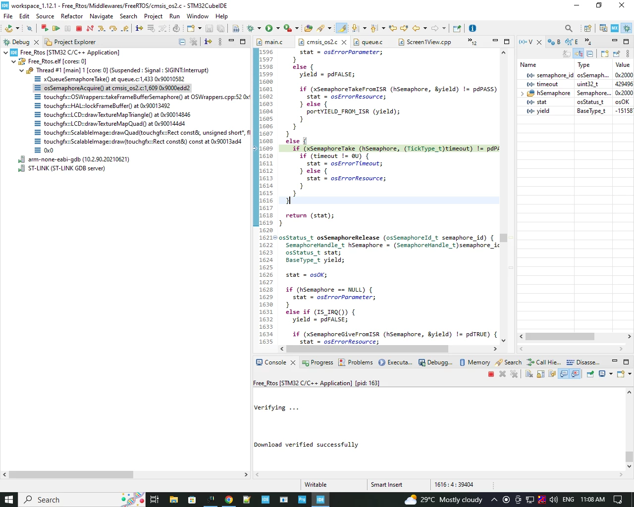

My screen displayed perfectly the problem is when I send the data from access port through uart it also display it but only for 2-3 times after that when I again send the data it stuck at  "configASSERT( pxQueue->uxItemSize == 0 )" this line when I stop debugging.

There is no source code in the project you sent. So it will be very difficult for someone to answer you.
It is not a good idea to use a semaphore when receiving data over the UART. So it is possible to lose data. Use a queue or stream buffer.

Seems that you are just defining pointer to your structure
 uart_Data *uart_Struct;
but never allocate memory for it ?
Thats maybe to root cause of your problems. You can add the memory allocation or just make it static by removing '*' on both declaration (main.c and model.cpp).
then probably this line on model.cpp
if (osMessageQueueGet(uartQueueHandle, &uart_Model[10], 0, 0) == osOK)
should be
if (osMessageQueueGet(uartQueueHandle, &uart_Model, 0, 0) == osOK)
or
if (osMessageQueueGet(uartQueueHandle, uart_Model, 0, 0) == osOK)
depending how you will improve the uart_model- stucture declaration
Maybe this helps you forward :thumbs_up:

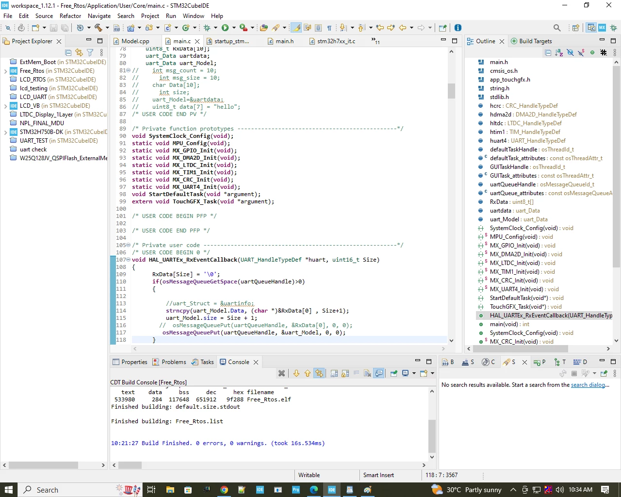

I tried what you said without using '*' but it didn't work the problem remains the same.
I send you the flow of it I hope it will help you to understand the problem.

Hello. Test with these, I little bit fix to stucture handling on put and get queue. And remove continuos initializing of HAL_UARTEx_ReceiveToIdle_IT at DefaultTask. Since I cant run your code it cannot be verified it 100%.
If its still hanging, try to comment out putting messages to queue, retrieving from queue etc until you find which operation is causing the problem. Your principle of using queue's should work fine since I build as practice a simple serial terminal on the TGFX which shows received strings from uart with queue from main.c. It also sends some test strings from UI button handler to model and then to other os process with TX queue.

Seems that your framebuffer needs 768 000 byte (800x480x2 byte(16 bit)) and you have place is it 512Kbyte area in SRAM (starting from 0x24000000) so its overflowing. Maybe you could reduce Y resolution so that it fits in 512 K and see does it help to the lock ups.(or use partial framebuffer or reduce color count to 256).
secondary no size checks...

After that I changed it here. But the problem did not solve.
Please check this.

Primary i mean this uart_Data *.. is ok , but is local for func where queue is used. Real memory is created with call Message Queue (keil.com)
good is create queue for minimal 2 elements and check if is created ok.

I have made some changes still the problem is same but now it stuck in this line
configASSERT( !( ( pvItemToQueue == NULL ) && ( pxQueue->uxItemSize != ( UBaseType_t ) 0U ) )
