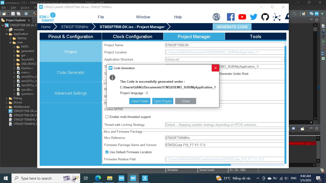

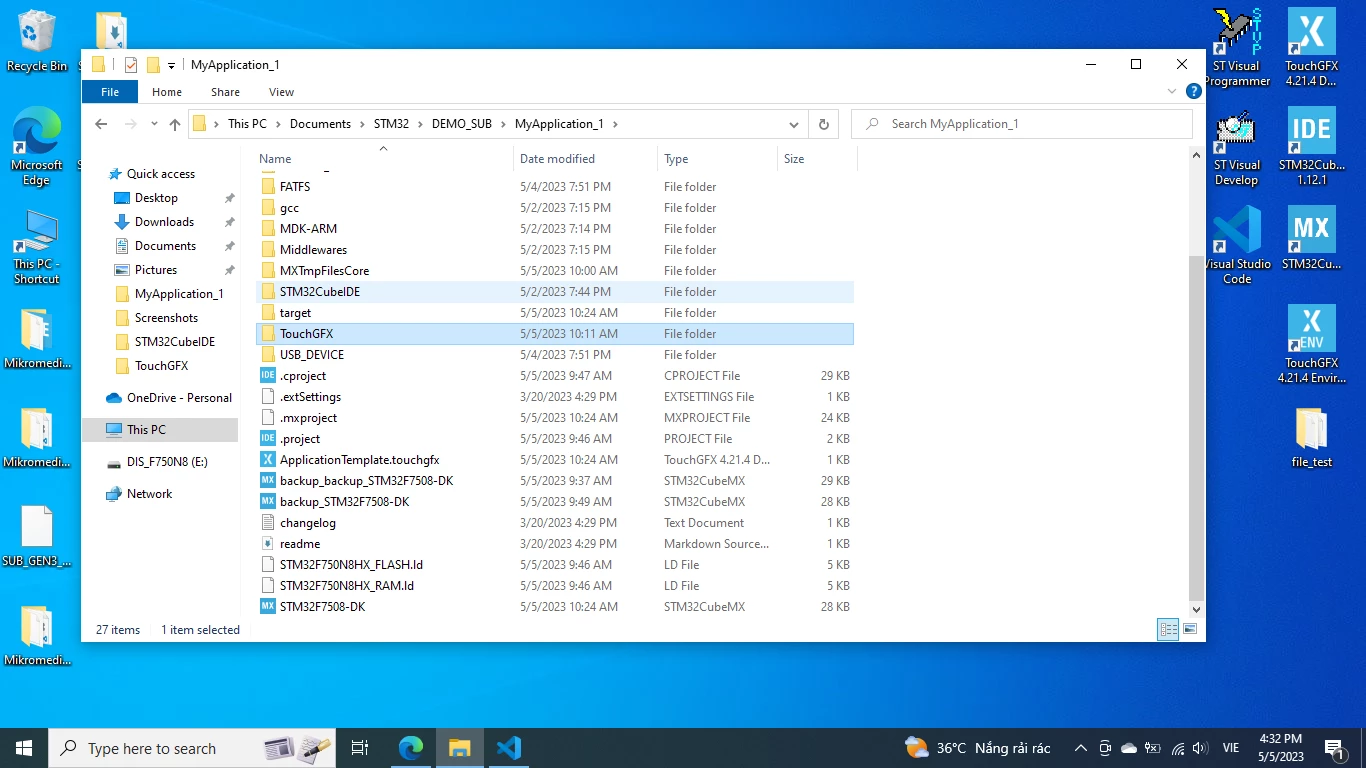

i accidentally made my touch gfx file run on c instead of c++ now what do i do to get it back??
Peter BENSCH
Peter BENSCHBest answer
May 5, 2023 8:28 AM UTC
You obviously opened a project with STM32CubeIDE that was created with TouchGFX, right?
You have to know that the TouchGFX part is based on C++, while the backend works with C, for which the IOC file is responsible. In this respect, the information is completely correct, because you are currently in STM32CubeMX being a part of STM32Cube.
Does it answer your question?
Regards
/Peter
