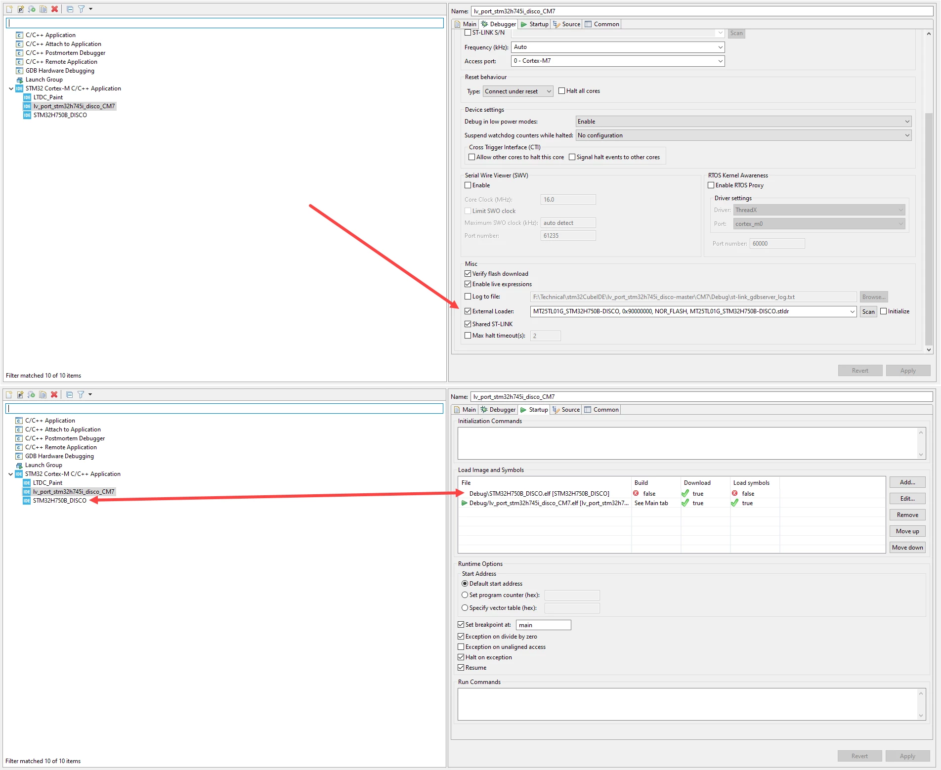

pk84
pk84Author
Oct 19, 2022 6:09 PM UTC
see screenshot below of my setup.
the lv_port_stm32h745.. project is loaded on the external QSPI flash (with external loader), so of course it does not need any QSPI init.
In the internal flash I load the STM32H750B_DISCO project, which is the program that makes the QSPI init + jump to the main program on the QSPI.
This internal flash program I already tested with another project (LTDC_Paint) and it works fine...
So that with the QSPI, external loader I should have considered, have I forgotten anything else?
I have no error, but even though nothing happens, no LED blinking, nothing...

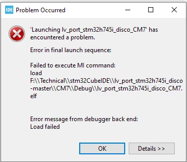

as mentioned in the beginning, I replaced the linkerscript content of the lv_port project (STM32H745XIHX_FLASH.ld) with the content of the linker from the LTDC_Paint project STM32H750XBHx_FLASH.ld.
The LTDC_Paint project I could already test on external QSPI, and it works... so I assume the the linkerscript content should be correct, or is this wrong?
But maybe something is wrong in the lv_port project, so I tried to load this project first to the internal (128kB) flash and test it.
I have commented out as much as possible and only added a LED blink function.
Unfortunately I get the following error message when loading.

ok, I forgot to change to internal flash in the ld-script, because of that I got the Error above.
So the lv_port program looks ok, at least the blink part... but I have no chance to make it work on the external flash - still nothing happens?? But no error.. how can I debug this? Or can somebody port this lv_port H745 to H750 for me?
