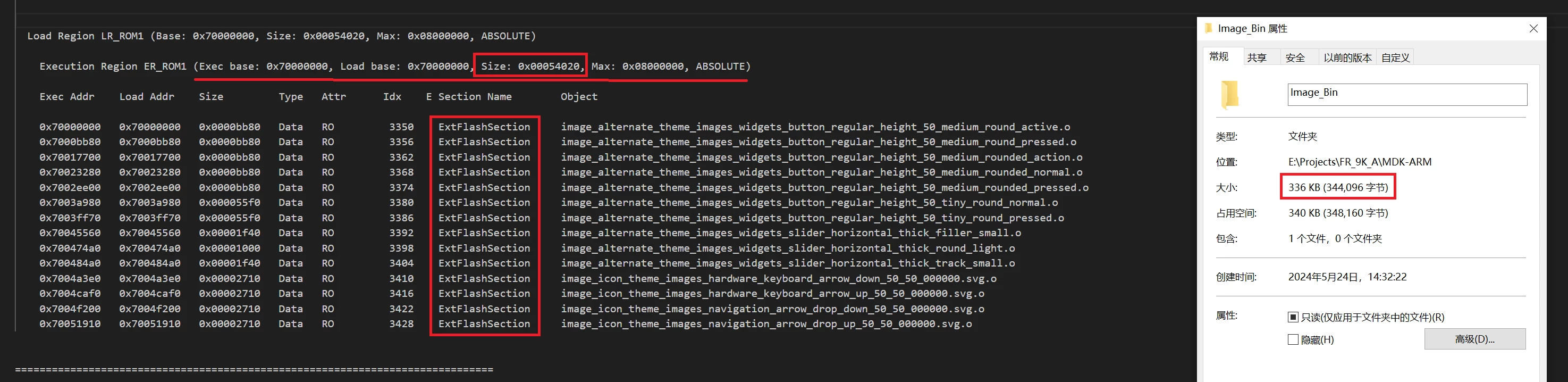

The map file info:

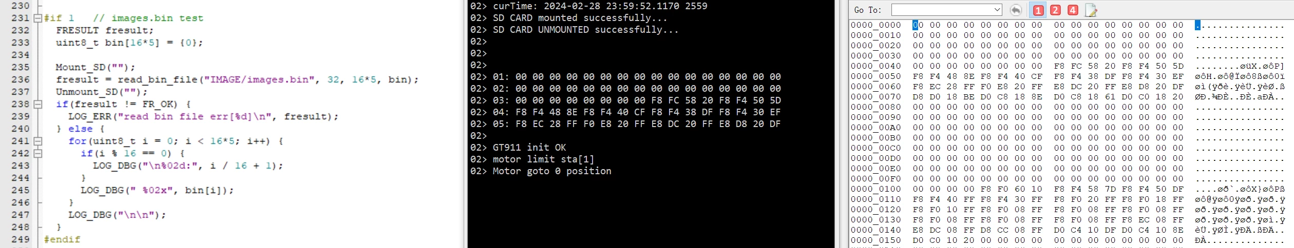

the read_bin_file() test result:
