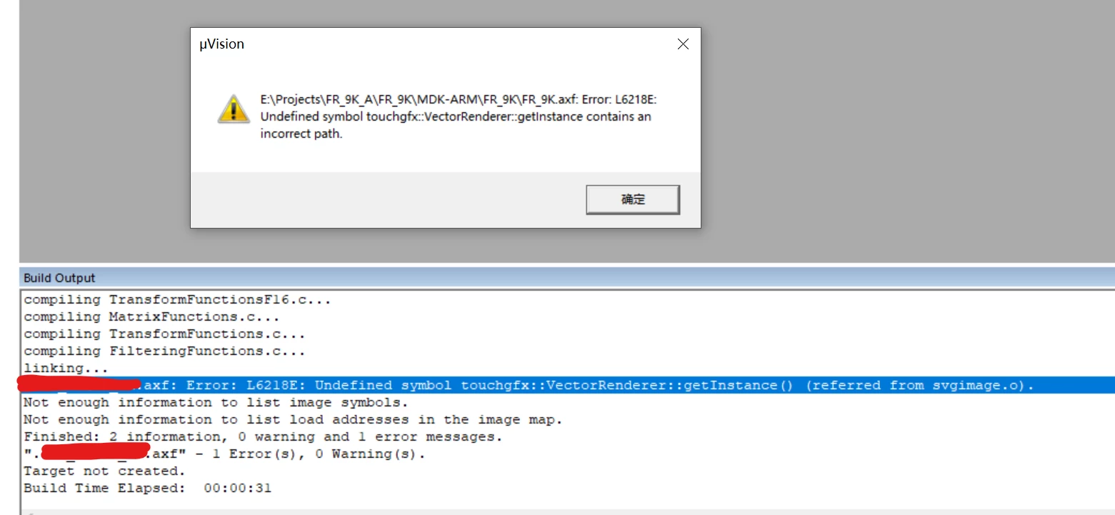

Hi there,
In my touchGFX project, I import an SVG file.
I can compile and simulate the UI page using TouchGFX Designer, which works as expected.
However, after I finished the design in TouchGFX Designer and tried to compiler the project by MDK-ARM, the following error was present:
(When I delete the SVG object in TouchGFX Designer, everything works well again.)
I don't know what this means, how do I resolve it?
Thanks for your help!

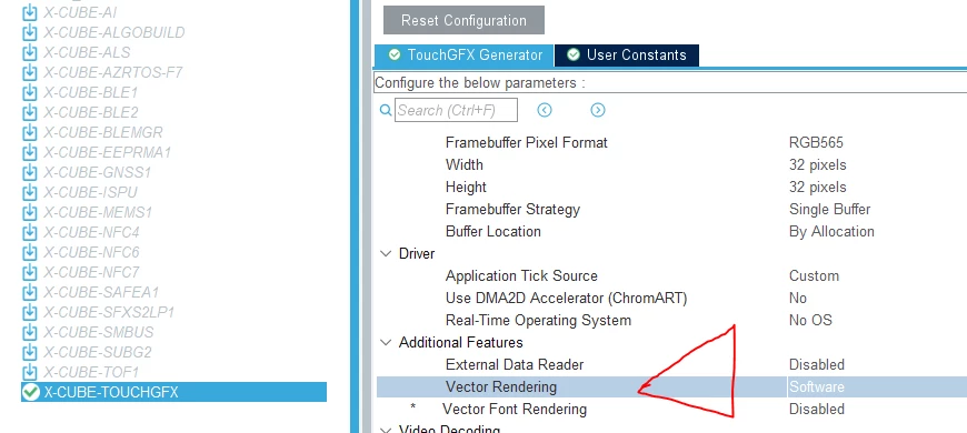

@GaetanGodart thanks for your reply
It can work well with the touchGFX Designer in simulation mode.
My question can be resolved by enabling "Vector Rendering" in cubeMx.
