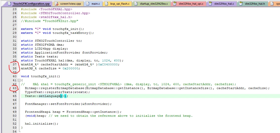

Hi,Martin
​I'm doing the same thing, badly without success.
I use STM32F429+SDRAM+SPI-Flash with the intention of putting the assets in spi-flash and using the asset data for touchgfx by caching it.
I am referring to the official documentation <Using Non-Memory Mapped Flash for storing images> and <Caching Bitmaps>.But it didn't work out.
The current situation is to enter hardfault while executing the "void touchgfx::Texts::setLanguage(touchgfx::LanguageId id)" method in the file <texts.cpp>.It happens specifically at the "currentLanguageTypedText = typedTextDatabaseArray[id];" code.The specific code implementation is as follows:

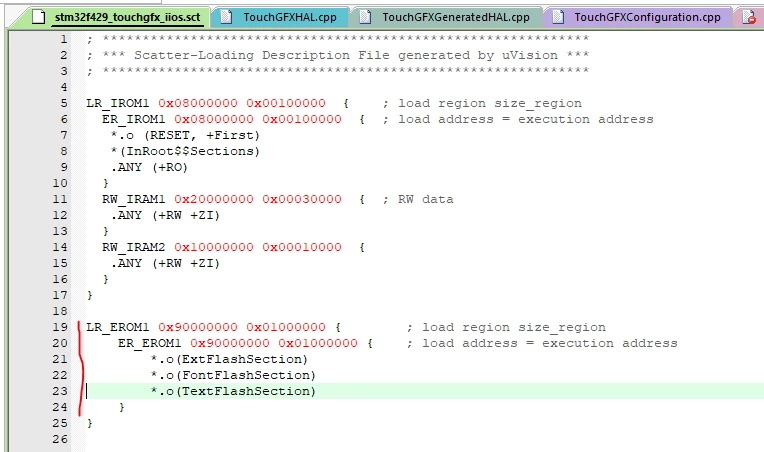

A linked description file for putting assets into SPI-FLASH:
The cache in file <TouchGFXConfiguration.cpp> is configured as follows:

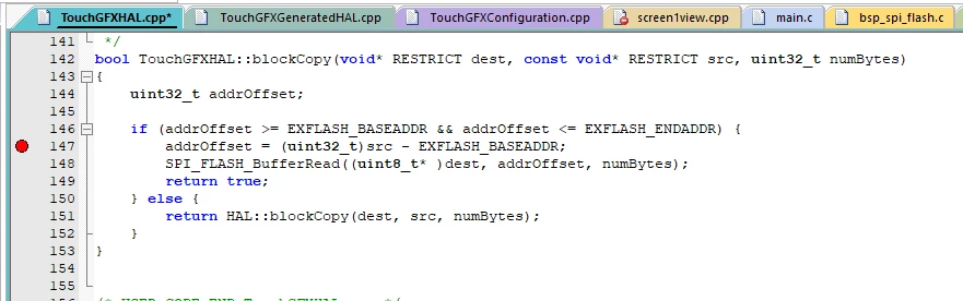

The location where the hardfault occurred is as follows:
I have been in hardfault without entering the "TouchGFXHAL::blockCopy" method before, because I am new to touchgfx, I don't know where the problem occurs,  <Using Non-Memory Mapped Flash for storing images> and <Caching Bitmaps> two official documents I don't understand very well, I hope you can help me out, thanks.
Martin KJELDSEN
Principal III
June 2, 2020
That's because TouchGFX does not contain the addresses for the glyphs in the program, so it cannot call blockCopy() with something that makes sense to be translated into something on the SPI flash. You need to take a look at binary fonts and font caching on the support site.
