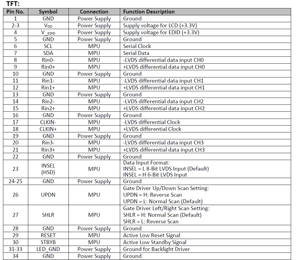

Hello, I want to use the same STM32 MCU to controll a TFT with LVDS interface, so I don't know how I should connect the TFT pins into the MCU.
There are a MCU that have a LVDS pins that connect directly with TFT or I need a Converter of LVDS to RGB connector to connect the TFT to RGB pins in order to use LTDC library?
I put here the datasheet of TFT: https://eu.mouser.com/datasheet/2/271/Microtips%20Technology-8-28-2017-MTD0801PZL%20spec1-1181493.pdf

This is an LVDS display,you need a RA8877 chip, or something like it.
60MHz pixel clock will be ok.

Use a RGB interface TFT or add a RGB to LVDS chip. EXP. TI DS90C385​
