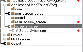

I have a little problem and dont wanna create a special topic for it, could you answer here.
I changed screen name from Screen2 to MainScreen,
but every time i click "Generate Code" in TouchGFX Designer, it generates old screen's folder and cpp file.
Project works fine If i delete the folder, but what should i do resolve the problem?
I guess it is my bad, but i still can not find what did i forget to change.
Thanks
Anton
Update:
Deleted Screen2.hpp and problem was resolved
