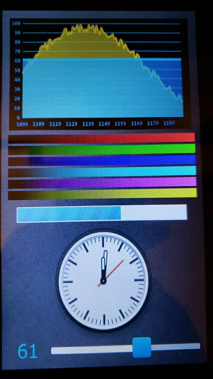

You can add many lines on the same DynamicGraph in TouchGFX Designer. Use them like the first one.
Here is my test: the first graph (yellow) is sine with random noise and second one (blue) is slider value (61)

Your picture is a SINGLE graph line. This is a method of drawing large amount of data points when new data is overwrites old one in a circular buffer.
Take a note of X axis labels: 1270-1300 is an old data being replaced by new one (1300-1360)

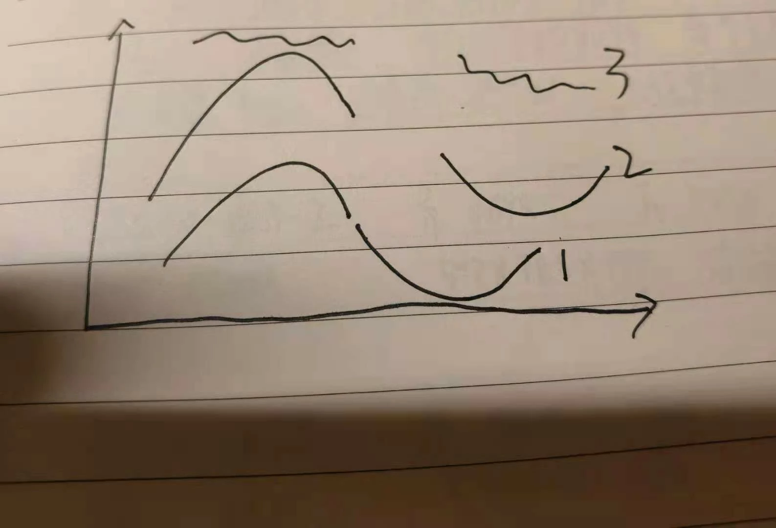

Can you draw what exactly you need on a sheet of paper?

Line1 is the current effect, I want to achieve the effect of line2, the middle interval is wider0693W00000Dpsh3QAB.jpg
