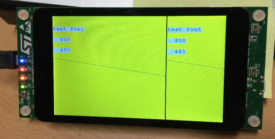

I'm using BSP Library for STM32469i-Discovery.
Create a new project using CubeMX, added some code and compile it.
the result is here.

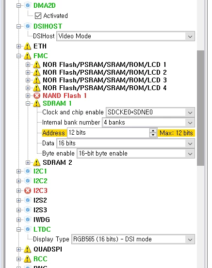

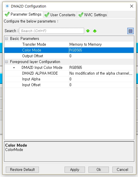

my CubeMX project configure is here.
No change is made to any configure LCD.
here is my main code....

Please, help.
