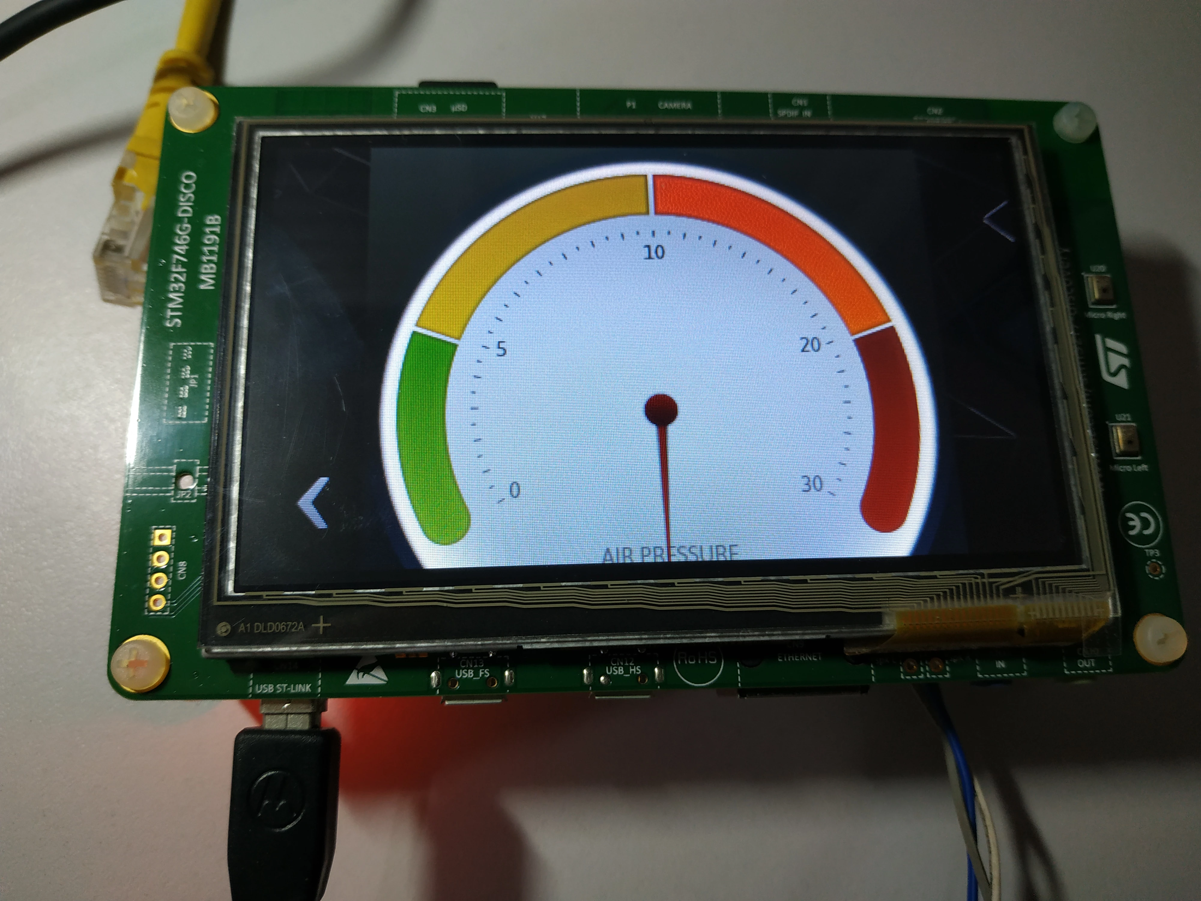

Hi.
I would like to know how to use Canvas Widgets from scratch. Especially this Widget: https://github.com/touchgfx/touchgfx-open-repository/tree/master/widgets/Gauge
I already read the readme.md from open repository and also ​this post https://touchgfx.zendesk.com/hc/en-us/articles/205074491-Canvas-Widgets?mobile_site=true
But can't understand how to really integrate inmy project, which files modify and how to manipulate the widget.
Is there any code example about it?​

Example code is nowhere to be found, I copied some things I see in the generated files for other screens.
This is how I made it work.
I created a screen in the designer with one box on it to make it blank.
copied the Gauge cpp and hpp files into the project. I put them in with the core files (for now I suppose)
put the bitmap files for the background and center in TouchGFX/assets
generated code in the designer to get the screen built and the bitmaps converted.
in the view .cpp file I added and configured the gauge, added an updating function, and setup the canvasbuffer
GaugeScreen1View::GaugeScreen1View()
  touchgfx::CanvasWidgetRenderer::setupBuffer(canvasBuffer, CANVAS_BUFFER_SIZE);
void GaugeScreen1View::setupScreen()
  GaugeScreen1ViewBase::setupScreen();
  mygauge.setBitmaps(Bitmap(BITMAP_MYGAUGE1_ID), Bitmap(BITMAP_GAUGE_NEEDLE_PIN_ID)); //BITMAP_GAUGE_BACKGROUND_ID
  mygauge.setLimits(-100, 200, 180, 450); // input value range, corresponding needle angle (up is 0, clockwise is positive)
  mygauge.setXY(245,5);
  mygauge.setValue(20);//
  add(mygauge);
void GaugeScreen1View::UpdateVal(DisplayData_t * pData)
  mygauge.setValue((pData->value));    //
the hpp file needs declarations

So, I tried to implement your example, but I cannot find "DisplayData_t" typedef. Is this your own implementation?
Bob Bailey
Senior
Jan 21, 2020 2:06 AM UTC
yes, thats my own definition, its a structure containing a bunch of things that I send to the GUI from another task. just replace it with something ordinary for testing. Passing data to the GUI is its own subject, there is a good youtube video on it. There is a thread about it on this forum also.

Now I can see the gauge on my display, but I can't change the value.
The gauge not fit on the display too.
Where in the code of the code should I call the "update_val" function?
I'm trying override handleTickEvent to update the gauge value but no success:

Bob Bailey
Senior
Jan 24, 2020 5:30 AM UTC
I used my own bitmap, you may need to resize or replace yours, you may need to change the needle size also
UpdateVal is usually called from the presenter. which is called from the model.
don't add the gauge in the update. you only add it when the screen is "setup" (this is likely your issue)
