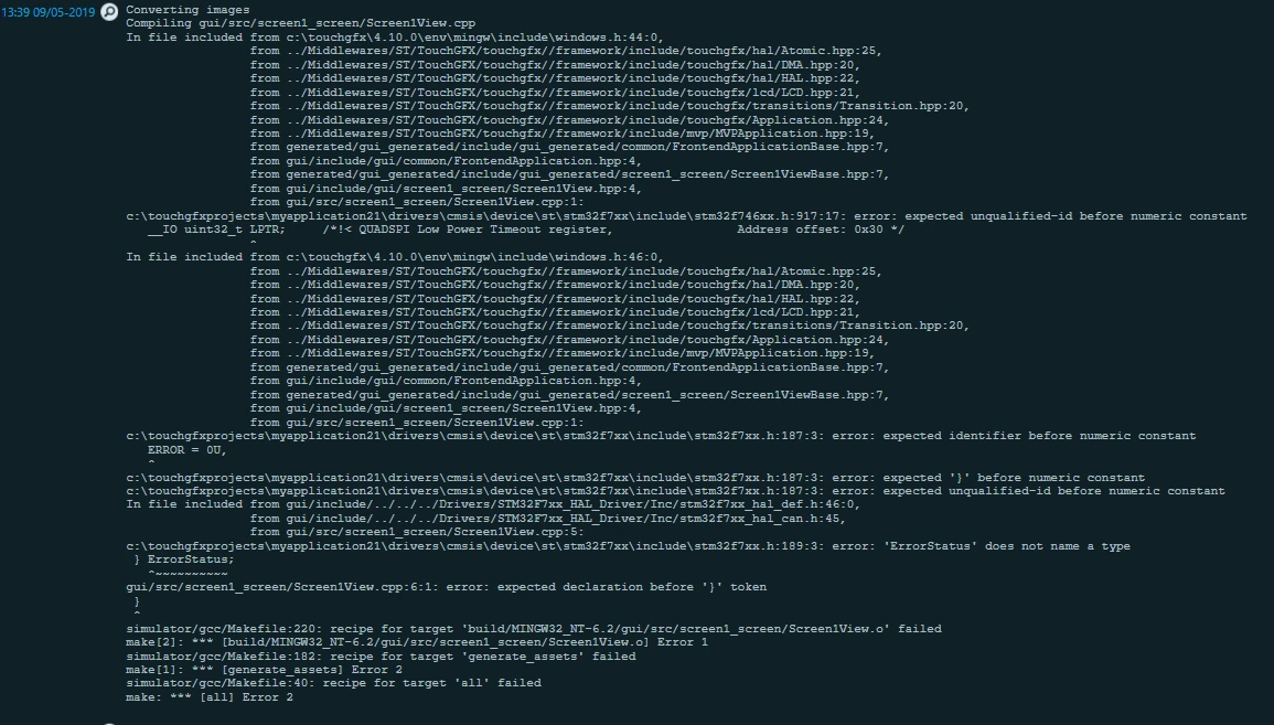

Hi Martin, I still have the same issue for including the stm32f7xx_hal_can.h library to my Touchgfx Project. I have tried to manually edit the paths of the include and I could get some progress in the includes. However, at one point I have this issue0690X000008BTLrQAO.png
I also tried to add an include path in the mainfile: include_paths := $(library_includes) $(foreach comp, $(all_components), $(comp)/include) $(framework_includes) Drivers/CMSIS/Device/ST/STM32F7xx/Include
but I still have that error:
In file included from gui/src/model/../../../../Drivers/STM32F7xx_HAL_Driver/Inc/stm32f7xx_hal_can.h:45:0,
                from gui/src/model/Model.cpp:3:
gui/src/model/../../../../Drivers/STM32F7xx_HAL_Driver/Inc/stm32f7xx_hal_def.h:46:23: fatal error: stm32f7xx.h: No such file or directory
 #include "stm32f7xx.h"
Maybe it has to do that the HAL CAN library is not supposed to work with the simulator?

Hi @FFont.18​,
Oh, yes, definitely! You are correct. The simulator makefile is very different.
If you have any target specific code in your project please sorround it with the following to prevent it being compiled for the simulator.
#ifndef SIMULATOR
#endif

Thank you very much I could include my library.
