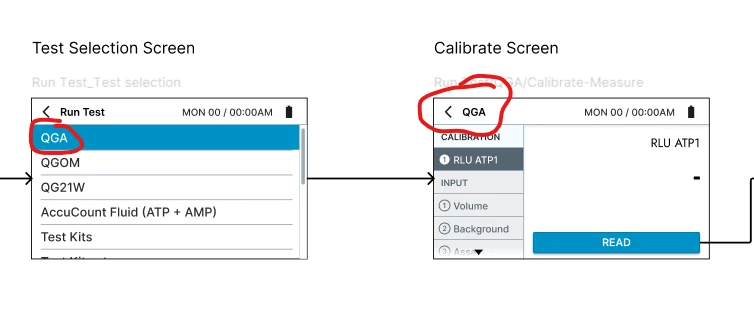

I have these screens
Every "calibrate screen" header text is based on the test selected on "test selection screen".
How can I update the text on the header based on the user selection?
Thanks a lot in advance

Oh I see, I thought you only have one screen.
You can use the model-view-presenter (MVP) to transmit data between your screens or with other tasks. In Tutorial 3 (Section: Saving Data) this is explained how to save data and retrieve it in different screens.
You can also read about the concept of a Screen here, so you better understand how the MVP works in TouchGFX.

Hi @Mohammad MORADI ESFAHANIASL thanks for the quick reply.
I understand how to update text wildcard in the same screens, but I'm looking for is how to send a text from one screen to another one.
My "test selection screen" will have 20+ different elements. I created those using a custom container. Its working great.
Then, everytime one of those elements is clicked, I jump into "calibrate screen", but I need the header text to be the same one as the clicked element.
For example, when the user clicks the element "QG21W", I need the header on the "calibrate screen" to be "QG21W".
I don't want to create 20 different screens, just to pass the argument to the new screen. Is that possible?
