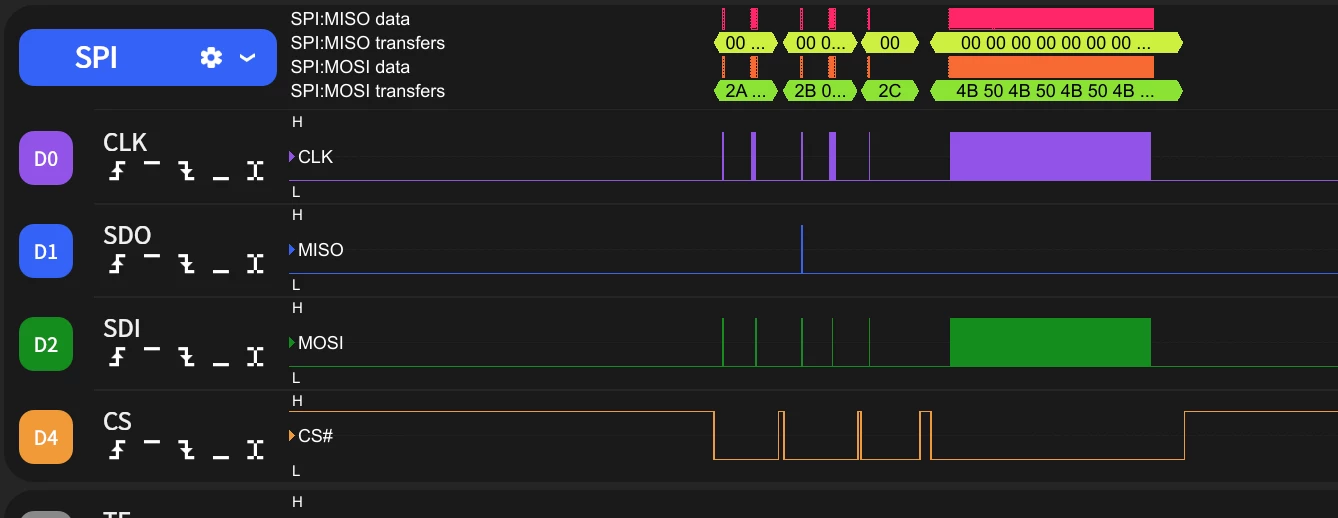

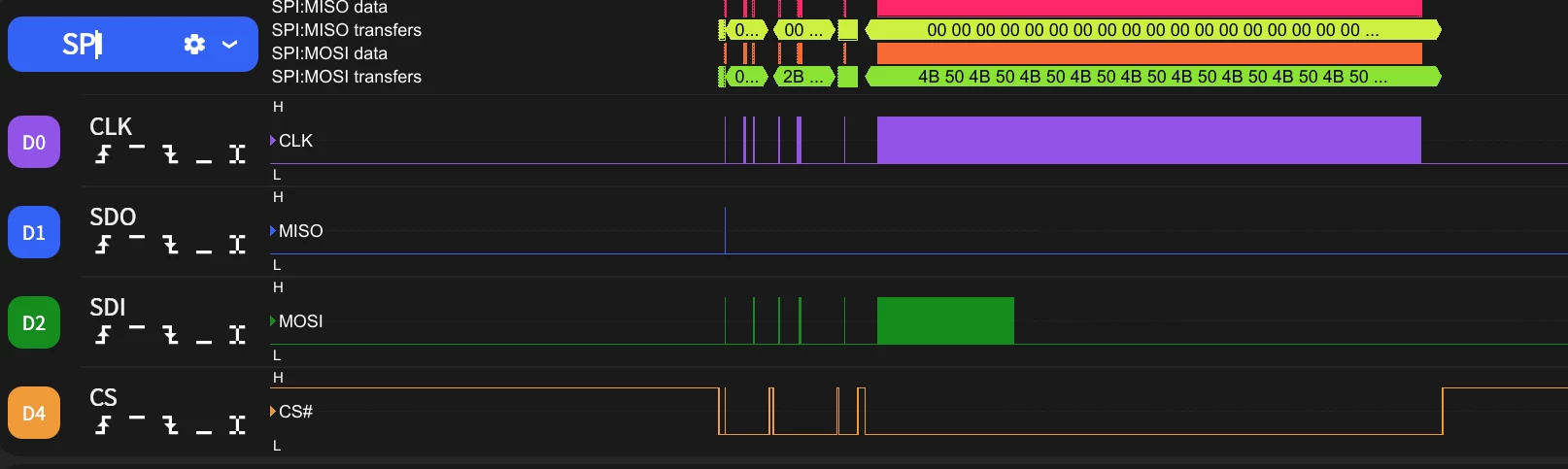

I code as above,but the screen displays black line:

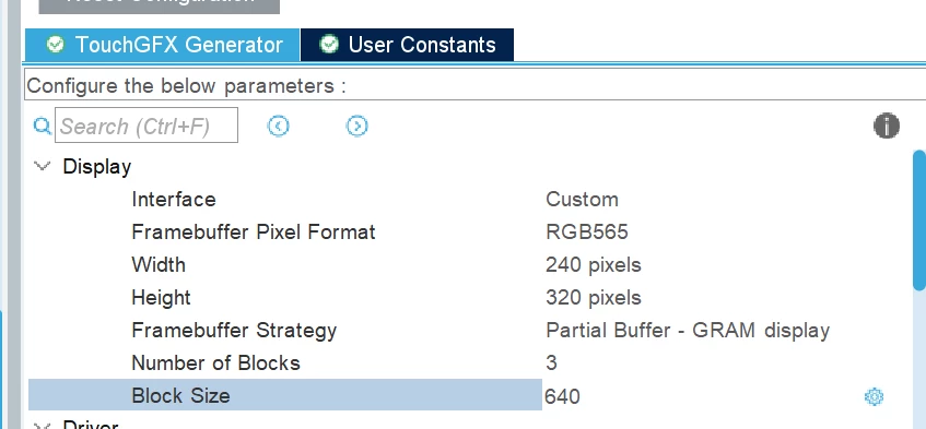

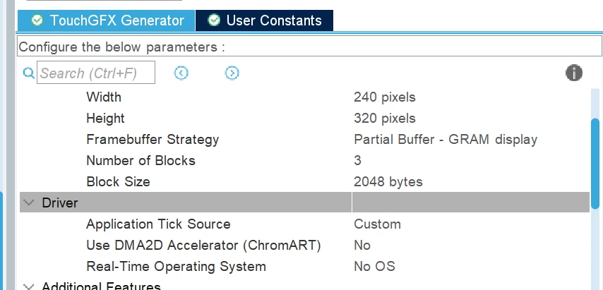

My board: NUCLEO-U083RC + X-NUCLEO-GFX01M2

ZhuangweiAuthor
Feb 16, 2026 2:11 PM UTC
Thank you for your reply.
The first two codes are my hal version code.
When I adjusted the Block Size from 2048 to 640, the black stripes disappeared.
And the waveform is as follows:
When I adjusted the Block Size from 640 to 2048, the black stripes appeared.
This is the transmission waveform after this function call.
 HAL_SPI_Transmit_DMA
MOSI data disappears in the second half of CLK line, but the clock is still running. I suspect there is something wrong with my dma transmission code.
Is there a sample project related to HAL version? I think I can learn from it.
